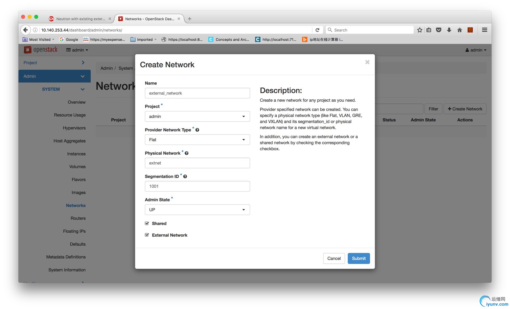

  •   Create a network with following info:
  •   Name:external_network
  •   Project:admin
  •   Provider Network Type: Flat
  •   Physical Network: extnet
  •   Segment ID: <any number>
  •   Admin State: UP
  •   Shared:checked
  •   External Network: checked

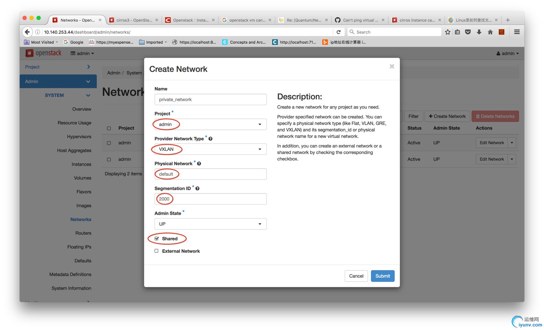

5.4 Create Internal Network
  • Name: private_network
  • Project: admin
  • Provider Network Type: VXLAN
  • Segment ID: <any number>.
  • Admin State: UP
  • Shared: checked
  • External Network: unchecked

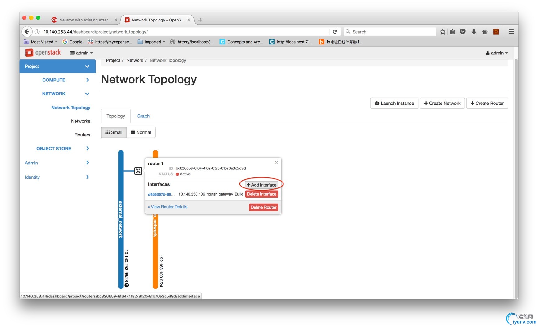

5.6 Create Router
  • Router Name: <Any string>
  • Admin State: UP
  • External Network: external_network

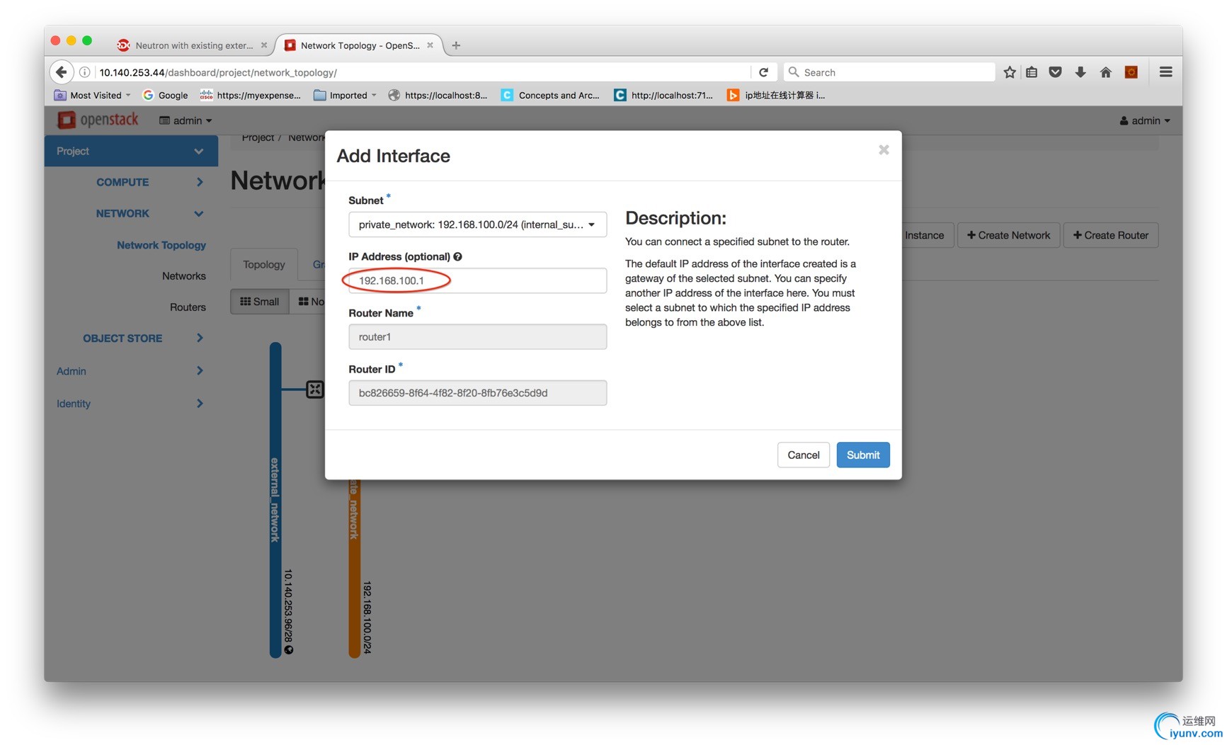

5.7 Associate Networks
  • Go back to Network Topology
  • Click “Add Interface”
  • IP Address: <gateway server ip of the internal network> e.g.192.168.100.1

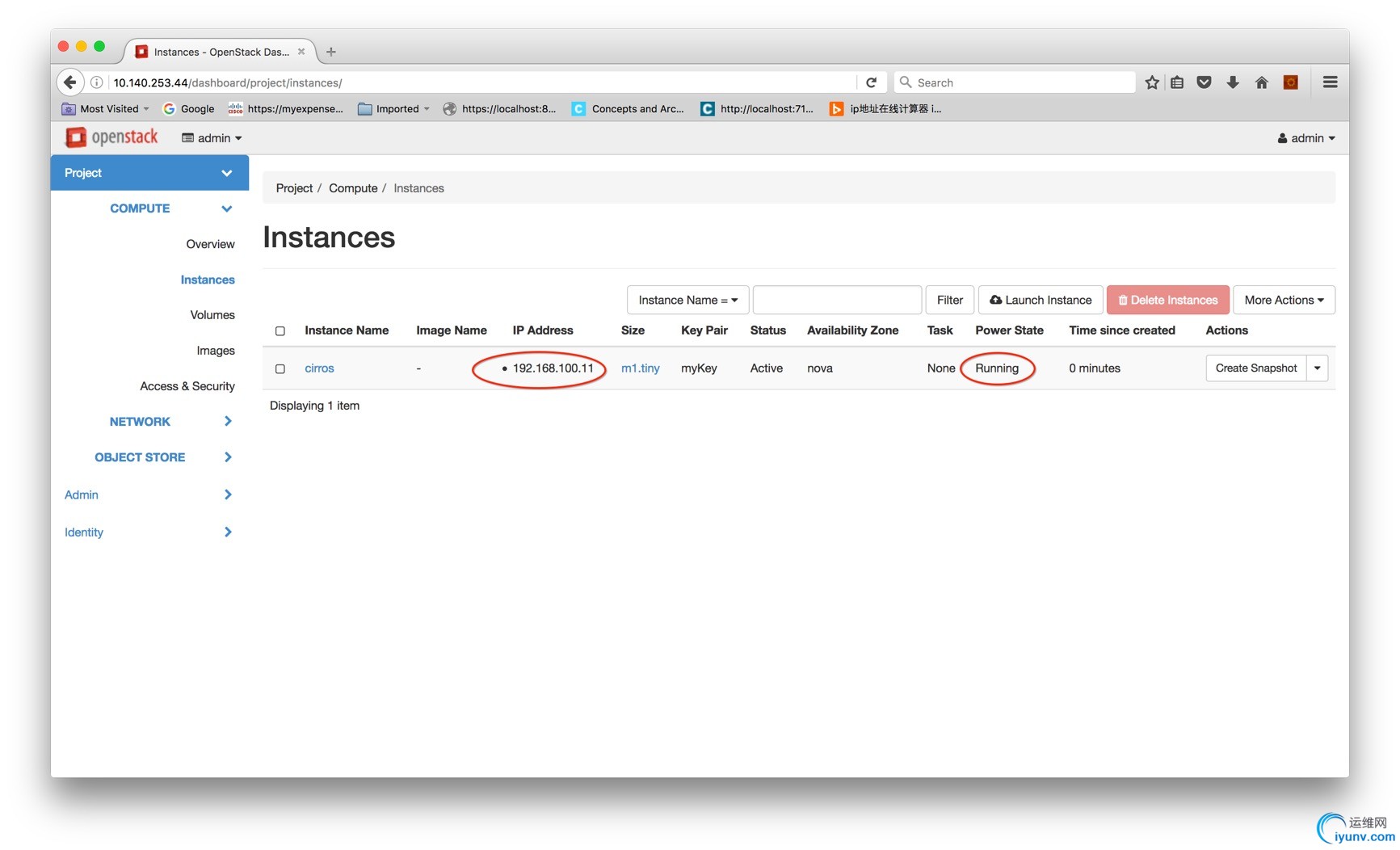

5.9 Create Instance
  • Go back to Network Topology, you should see the external network and the private network are connected with a router
  • Click“Launch Instance” button to create an vm
  • Instance Name: <any string>
  • Availability Zone: nova
  • Count:1
  • Boot Source: Image
  • Volume Size: <The min size of your image>
  • Create New Volume: YES
  • Delete Volume on Instance Delete:YES
  • Allocated:<Your image> e.g. cirros
          Choose appropriate flavor size.

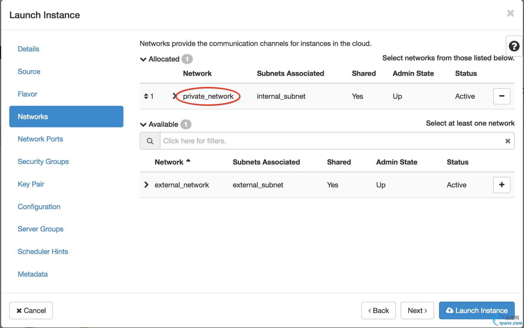

          e.g m1.tiny
          Choose the network you want to create an instance on.
          e.g. “private_network”
          Choose the key pair which you want to used for logging into the instance later on.
          Click “Launch Instance” to start instance.
          Once the instance is created successfully, you should see the Power State is changed to “Running”.

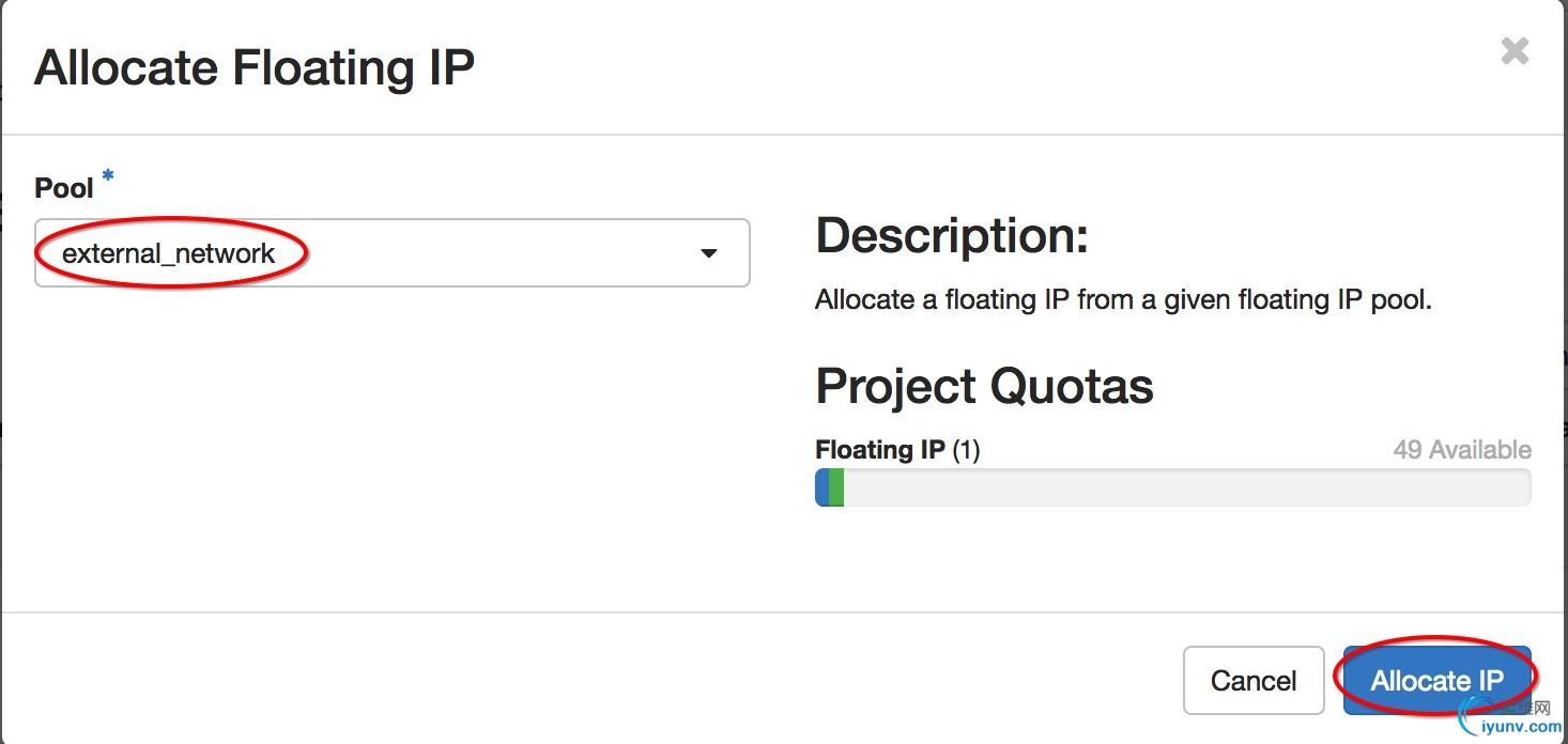

5.10 Allocate Floating IP
  • Click the instance drop-down list
  • Click Associate Floating IP
  • Click”+” button to creating an floating IP address in a specific Network.
  • If it’s already done, you can also choose an
    avaliable IP address from the drop-down list.
  • Choose the network you want to create an IP address on. (e.g. “External_network”)
  • Click “Allocate IP”

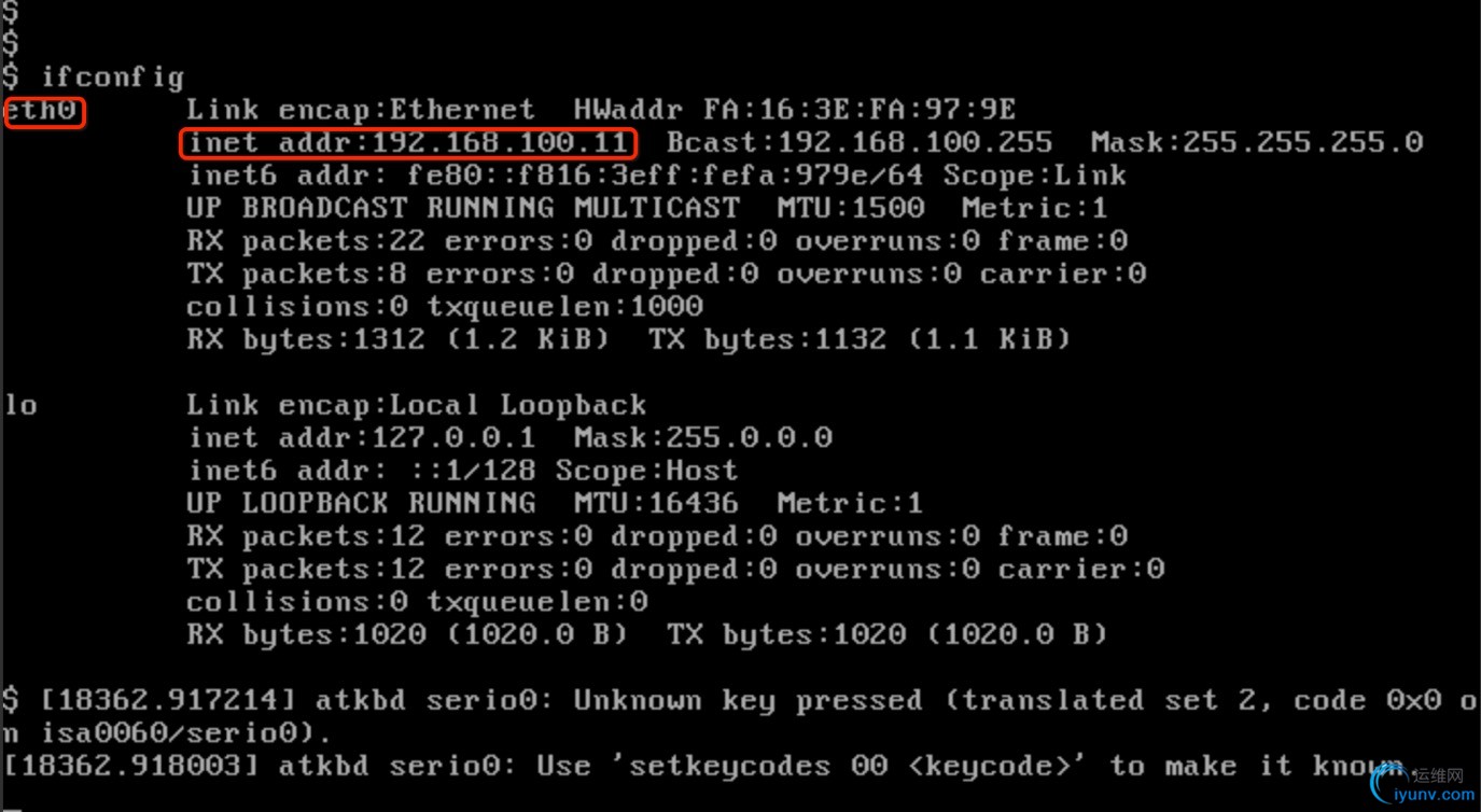

5.12 IP Binding
          If you check the network information, you would find that there is no any IPv4 address bind to the instance.
          Neither192.168.100.11, nor 10.140.253.100
DSC00036.jpg           Execute following 2 commands:
sudo ifconfig eth0 192.168.100.11 netmask 255.255.255.0
sudo route add default gw 192.168.100.1
         Now, the private IP address has been associated with the instance.
          (We do not need to bind the public IP 10.140.253.100 here, because the HTTP requests will be transferred to the outside world by the router which is connected “private_network”and “external_network”.

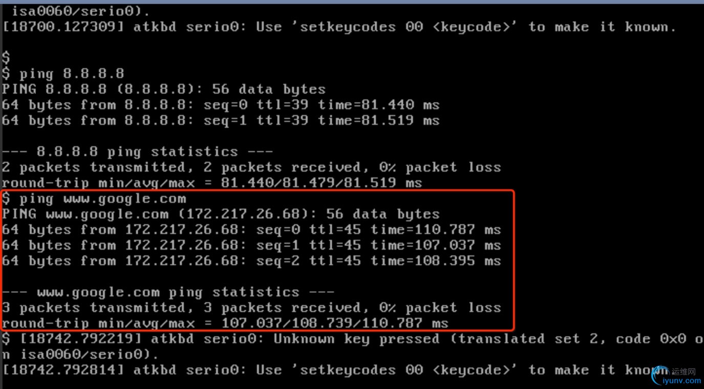

         Ping 8.8.8.8 is OK.
DSC00039.jpg           However, Ping by domain name is not working.
          e.g. ping www.google.com
          sudo vi /etc/resolv.conf
nameserver 123.123.123.123
nameserver 8.8.8.8
  Ping www.google.comis OK.
