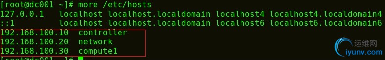

  修改各节点的/etc/hosts 文件
  测试各节点到openstack.org的连通性

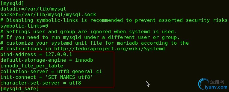

  修改/etc/my.cnf
  [mysqld]
  bind-address = 127.0.0.1
  default-storage-engine = innodb
  innodb_file_per_table
  collation-server = utf8_general_ci
  init-connect = 'SET NAMES utf8'
  character-set-server = utf8

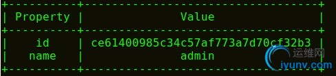

  2.2、Create tenants, users, and roles
  # export OS_SERVICE_TIOEN=123456
  # export OS_SERVICE_ENDPOINT=http://controller:35357/v2.0
  Create the admin tenant:
  # keystone tenant-create --name admin --description "Admin Tenant"
  Create the admin user:
  # keystone user-create --name admin --pass test01 --email admin@test.com
  Create the admin role:

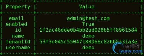

  Create the demo user under the demo tenant:
  # keystone user-create --name demo --tenant demo --pass test01 --email admin@test.com

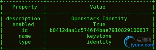

  Create the service entity for the Identity service:
  # keystone service-create --name keystone --type identity --description "Openstack Identity"

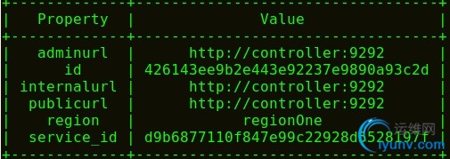

  Create the Identity service API endpoints:
  # keystone endpoint-create --service-id $(keystone service-list | awk '/ identity / {print $2}') --publicurl http://controller:5000/v2.0 --internalurl http://controller:5000/v2.0 --adminurl http://controller:35357/v2.0 --region regionOne

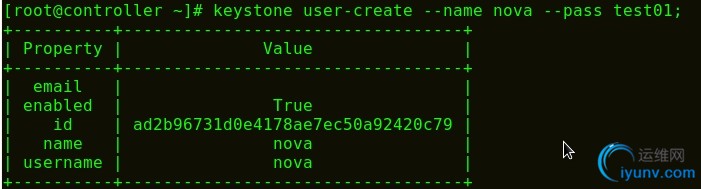

  # source admin-openrc.sh
  # keystone user-create --name nova --pass test01
  # keystone user-role-add --user nova --tenant service --role admin

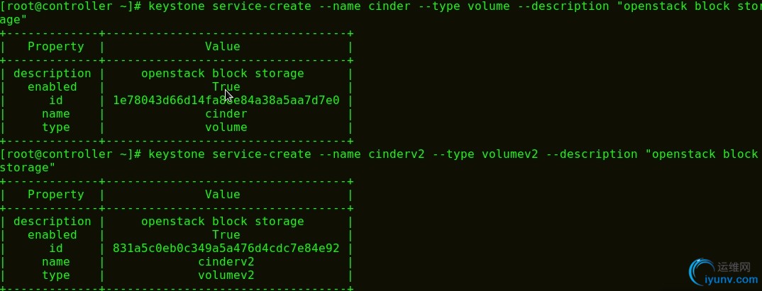

  # keystone user-create --name cinder --pass test01
  # keystone user-role-add --user cinder --tenant service --role admin
  # keystone service-create --name cinder --type volume --description "openstack block storage"
  # keystone service-create --name cinderv2 --type volumev2 --description "openstack block storage"

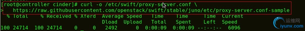

  Obtain the proxy service configuration file from the Object Storage source repository:
  # curl -o /etc/swift/proxy-server.conf \
  https://raw.githubusercontent.com/openstack/swift/stable/juno/etc/proxy-server.conf-sample
