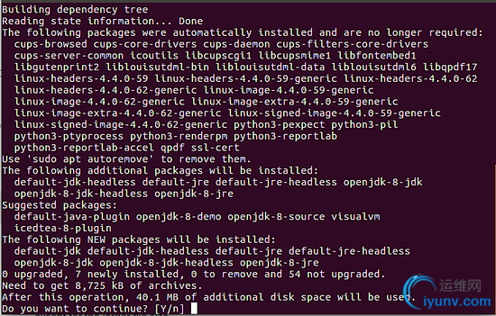

  Since Elasticsearch is written in Java, it has to be installed first. Use the commands below to install the open source versions of JRE and JDK:
  sudo apt-get install default-jre
  sudo apt-get install default-jdk
  These two commands will install the latest open-jre and open-jdk on your system. I'll use JAVA 8 here. The following images show, the output you will get when you do not have java installed and run the above commands.

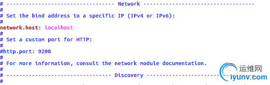

  Elasticsearch runs as a background process. But before we start it we have to edit the config file to add the current system as the host running the engine. use the following command to open the config file:
  sudo gedit /etc/elasticsearch/elasticsearch.yml
  Once the editor opens, you have to uncomment the line:
#network.host: 192.168.0.1  and then change the IP to localhost as shown in the image below:
  Now, we are ready to run the process. Use the following commands:

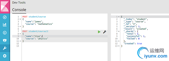

6.2 Insert some data to index
  We will be using the POST calls to insert data to index. The data to be inserted is in the form of JSON and so let us go ahead add students to the index. The Command is :
POST student/course
"name":"james",
"course": "mathematics"
  In the above command, "course" indicates the type of data that is being indexed. From the response, you can see that, this entry has got a unique>POST student/course/2
"name":"tina",
"course": "physics"
  Following are the images that show the response from the search engine when both the commands are run:
