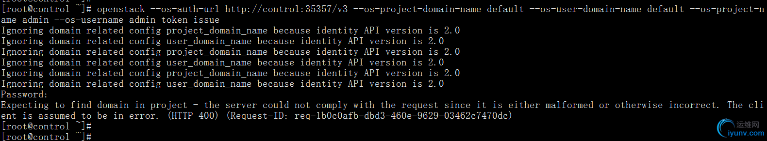

Openstack-Mitaka搭建时,用的ntpdate 做的时间同步,现在搭建这一步时报错,请大家指点一下,多谢!
openstack --os-auth-url http://control:35357/v3 --os-project-domain-name default --os-user-domain-name default --os-project-name admin --os-username admin token issue
[iyunv@control ~]# openstack --os-auth-url http://control:35357/v3 --os-project-domain-name default --os-user-domain-name default --os-project-name admin --os-username admin token issue
Ignoring domain related config project_domain_name because identity API version is 2.0
Ignoring domain related config user_domain_name because identity API version is 2.0
Password:
Expecting to find domain in project - the server could not comply with the request since it is either malformed or otherwise incorrect. The client is assumed to be in error. (HTTP 400) (Request-ID: req-1b0c0afb-dbd3-460e-9629-03462c7470dc)
[iyunv@control ~]#
[iyunv@control ~]# ping control
PING control (192.168.206.22) 56(84) bytes of data.
64 bytes from control (192.168.206.22): icmp_seq=1 ttl=64 time=0.021 ms
64 bytes from control (192.168.206.22): icmp_seq=2 ttl=64 time=0.016 ms
^C
--- control ping statistics ---
2 packets transmitted, 2 received, 0% packet loss, time 999ms
rtt min/avg/max/mdev = 0.016/0.018/0.021/0.005 ms
[iyunv@control ~]#

发表于 2017-2-8 11:06:51 | 显示全部楼层
http 400错误,应该是apache配置有问题,你直接复制官方文档上面的配置就可以用。

 楼主| 发表于 2017-2-9 11:43:06 | 显示全部楼层
fc1zeal@sohu.co 发表于 2017-2-8 11:06
http 400错误,应该是apache配置有问题,你直接复制官方文档上面的配置就可以用。 ...
多谢! 还是不成,报错。我已经将官网的,复制到配置上了。能加好友吗?
发表于 2017-11-24 12:38:29 | 显示全部楼层
我也碰到该问题了,请问你是怎么解决的
