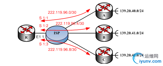

   LAB1:使用E1线路实现多个64K专线连接:
    STEP1:了解相关命令:
    进入controller配置模式:contriller t1/e1 number ;
    选择帧类型:framing crc4/no-crc4 ;
    选择line-code类型:linecode ami/b8zs/hdb3 ;
    STEP2:具体配置:
    E1连接3条64K专线,帧类型为NO-CRC4,非平衡链路,路由器具体设置如下:
    hostname shanxi ;
    controller E1 1 (进入E1控制器) ;
    framing NO-CRC4 ;
    linecode hdb3 ;
    channel-group 1 timeslots 1 (建立逻辑通道组与时隙的映射,timeslots 1(类似PVC)对应下面的s1:1(类似Sub-if));
    channel-group 2 timeslots 2 ;
    channel-group 3 timeslots 3 ;
    exit ;
    in s1:1 ;
    ip add 222.119.96.1 255.255.255.252 ;
    in s1:2 ;
    ip add 222.119.96.5 255.255.255.252 ;
    int s1:3
    ip add 222.119.96.9 255.255.255.252 ;
    ip route 139.20.40.0 255.255.255.0 s1:1 (配置默认路由);
    ip route 139.20.41.0 255.255.255.0 s1:2 ;
    ip route 139.20.42.0 255.255.255.0 s1:3 ;

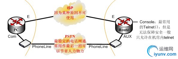

   LAB2:带外网管(Modem Connections):通过异步Modem/(PSTN程控交换机/语言交换网/7号信令网/SS7)远程控制路由器的AUX口:
    STEP1:在开始通讯前的准备工作:
    使用Con线通过Console口进行近程Telnet配置来控制Aux和Modem之间的通讯;
    先查看Aux绝对线路号:Con口线路号为0、异步串口线路号为1~X(X=8×网络模块数量→网络模块接口8个一组→八爪鱼)、Aux的绝对线路号为X+1;
    进入Aux口:(c)#line 65/aux 0(使用绝对线路号/相对接口名进入Aux口)→flow contorl hardware(硬件流控)→transport input all(容许所有协议)→modem inout(容许出/入方向的呼叫)→password 123(配置密码)→login(登录许可,同Con口的配置,no login表示不设防);
    然后设置enable密码即可;
    STEP2:使用AT命令集配置Modem:
    笔记本通过Com口、RJ-45转DB-25转换器在Modem的DB-25接口配置,每个品牌的AT命令集不同,需要查询文档;常用的:
    AT(开始配置)→AT&(查看配置)→AT&f(恢复默认,有些为AT&F1)→ATS0=3(设置应答指示响铃次数,ATS0=0表示不响铃)→AT&W(保存设置)→ATe0(关闭字符回显)→ATe1(打开字符回显);
    STEP3:按图配置;
    STEP4:拨号→使用超级终端。

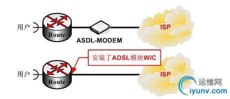

   LAB3:PPPoE(ADSL的服务:Route As PPPoE's client):
    STEP1:VPDN(虚拟拨号专网):
    these vpdn commands are not needed with cisco ios software release 12.2(13)
    sh ru 查看:
    vpdn enable ;
    no vpdn logging ;
    vpdn-group pppoe ;
    request-dialin ;
    protocol pppoe ;
    STEP2:internal ethernet network:
    in e0 →ip add 192.168.1.1 255.255.255.0 →ip nat inside ;
    STEP3:xDSL inteface (ADSL卡上的接口):
    in ATM0 →no ip address →no atm ilmi-keepalive →dsl operation mode auto →bundle-enable →hold-queue 224 in (allthing were defaulted,不需要配);
    STEP4:ATM sub-interface:
    in ATM0.1 point-to-point →pvc 1/1 (VPI/VCI) →pppoe-client dial-pool-number 1 (将虚拟ATM子接口放入pool中) →pvc 1/1 is an example value,that must be changed →to match the value used by the isp ;
    STEP5:IF Dial:
    the pppoe client code ties into a dialer interface upon which a virtual-access interface is clound.
    in dialer 1 →ip address negotiated(与ISP协商IP地址) →ip mtu 1492 (ethernet mtu default=1500 ;1492+PPPOE headers=1500) →ip nat outside →encapsulation ppp →dialer pool 1(去dialer pool 1 中,调用刚放入的ATM的子接口);
    STEP6:认证(CHAP OR PAP):
    the isp instruets you about the type of authentication to use.
    PAP:ppp authentication ppp callin →ppp pap send-username username password password
    CHAP:ppp authentication chap callin →ppp chap hostname username →ppp chap password password ;
    STEP7:NAT:
    access-list 1 permit 192.168.1.* 0.0.0.255 →ip nat inside source list 1 interface dialer1 overload  →ip route 0.0.0.0 0.0.0.0 dialer1 →end 。
