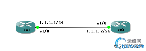

  sw-1(config)#interface ethernet 1/0 #进入接口模式
  sw-1(config-if)#ip address 1.1.1.1 255.255.255.0 #接口模式,配置接口 e1/0 IP 地址为1.1.1.1
  sw-1(config-if)#no shutdown #激活接口
  sw2(config)#interface ethernet 1/0 #进入接口模式
  sw2(config-if)#ip address 1.1.1.2 255.255.255.0 #接口模式,配置接口 e1/0 IP 地址为1.1.1.2
  sw2(config-if)#no shut
  sw2(config-if)#exit
  *Mar 1 00:03:25.259: %LINK-3-UPDOWN: Interface Ethernet1/0, changed state to up
  *Mar 1 00:03:26.259: %LINEPROTO-5-UPDOWN: Line protocol on Interface Ethernet1/0, changed state to up
  sw2(config)#do ping 1.1.1.1
  Type escape sequence to abort.
  Sending 5, 100-byte ICMP Echos to 1.1.1.1, timeout is 2 seconds:
  Success rate is 80 percent (4/5), round-trip min/avg/max = 52/73/96 ms
  sw2(config)#
