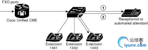

标题这么写,有点不太符合。具体的情况应该是这样的,有一台3825路由器,内插有PVDM2-64模块和VIC2-4FXO模块。路由器连接一台可端口供电的Cisco3560交换机, IP电话连在交换机上。 电话网络结构希望是这样的:  PBX Model
The simplest model is the PBX model, in which most of the IP phones in your system have a single unique extension number. Incoming PSTN calls are routed to a receptionist at an attendant console or to an automated attendant. Phone users may be in separate offices or be geographically separated and therefore often use the telephone to contact each other. For this model, we recommend that you configure directory numbers as dual-lines so that each button that appears on an IP phone can handle two concurrent calls. The phone user toggles between calls using the blue navigation button on the phone. Dual-line directory numbers enable your configuration to support call waiting, call transfer with consultation, and three-party conferencing (G.711 only). Figure 3 shows a PSTN call that is received at the Cisco Unified CME router, which sends it to the designated receptionist or automated attendant (1), which then routes it to the requested extension (2). 图1 Incoming Call Using PBX Model DSC0000.jpg How to Configure Phones for a PBX System 下面先了解一下基本概念,然后在看如何在Cisco3825上配置SCCP电话。

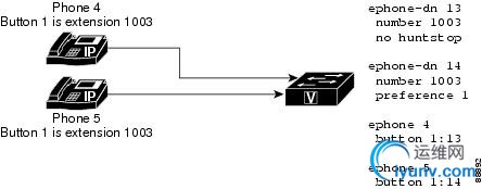

. 同一个电话号码有两个单独的虚拟语音端口,因此可以创建两个单独的呼叫连接。. 可以是双线路姓名地址录号码(SCCP only),也可以是单线路姓名地址录号码。. 可以显示在一部电话的不通按钮上,或者显示在不同的电话上。. 当使用较少的电话号码获得较多的呼叫连接时,可以使用此类型。图4 Two Directory Numbers with One Number on One Phone: DSC0003.jpg 上图显示,两个电话按钮绑定了相同的电话号码1003,每一个按钮绑定不同的姓名地址录号码(按钮1绑定姓名地址录号码13, 按钮2绑定姓名地址录号码14),当姓名地址录号码是单线路的时候,每一个按钮都可以创建一个单独的呼叫连接;当姓名地址录号码是双线路的时候,每一个按钮可以创建两个呼叫连接,总共四个。图5 Two Directory Numbers with One Number on Two Phone: DSC0004.jpg 上图显示两部电话,每部上的一个按钮绑定着相同的电话号码。因为两部电话上的按钮绑定着不同的姓名地址录号码,所以在这两个按钮上产生的呼叫是相互独立的。同一时间,电话4可以使用1003号码创建一个呼叫连接,电话5可以使用1003收到一个不同的呼叫连接。图4和图5,展示了两个姓名地址录号码绑定一个电话号码的情形,这种情形用来提供一个小的搜索组能力(a small hunt group capability)。例如图4,当在按钮1上的姓名地址录号码忙,无法应答时,呼入1003的连接会翻转到和按钮2绑定的姓名地址录号码上。相似的,对于图5,如果电话4上的按钮1忙,一个呼入1003的连接会翻转到电话5的按钮1上。(4)双号码(Dual-Number)一个双电话号姓名地址录号码特性如下:. 有两个电话号码,一个主的和一个从的。. 如果是单线路姓名地址录号码,则只可以创建一个呼叫。. 如果是双线路姓名地址录号码,同一时间可以创建两个呼叫。(SCCP only). 当想使一个按钮拥有两个电话号码,且只使用一个姓名地址录号码的情况下,使用此类型。图6 Dual-Number Directory DSC0005.jpg (5)共享线路(Shared)  一个共享线路姓名地址录号码有如下特性:

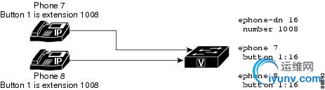

. 两个电话上使用了相同的姓名地址录号码,电话号码。. 同一时间只能创建一个呼叫,且这个呼叫将显示在两部电话上。. 当你想要使用多个电话对一个呼叫进行应答时,使用此类型。因为这些电话共享同样的姓名地址录号码,如果这个姓名地址录号码在一部电话上被一个呼叫连接占用,那么这个姓名地址录号码在第二部电话上将不可用于其它的呼叫连接。如果在一部电话上的呼叫不挂断,那么可以从第二部电话上重新得到。图7 Shared Directory Number DSC0006.jpg (6)覆盖(Overlaid)  一个覆盖姓名地址录号码有如下特性:
