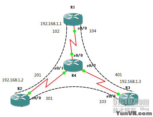

拓扑图:
1.把路由器R4配置为帧中继交换机
frame-relay  switching   *配置为帧中继交换机

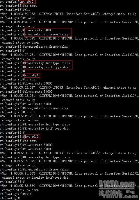

2.在路由器R4上配置接口的时钟频率、封装类型、lmi类型和帧中继dce端
int s0/0
no shut
clock rate 64000   *设置时钟频率
encapsulation frame-relay    *封装为帧中继
frame-relay lmi-type cisco   *lmi类型为cisco
frame-relay intf-type dce    *帧中继的dce端
int s0/1
no shut
clock rate 64000
int s0/2
no shut
clock rate 64000
exit

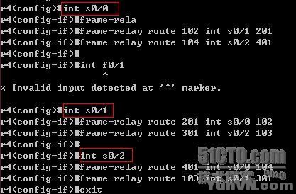

3.在路由器R4接口上配置帧中继交换表
int s0/0
frame-relay route 102 interface Serial0/1 201
frame-relay route 104 interface Serial0/2 401
int s0/1
frame-relay route 201 interface Serial0/0 102
frame-relay route 301 interface Serial0/2 103
int s0/2
frame-relay route 401 interface Serial0/0 104
frame-relay route 103 interface Serial0/1 301

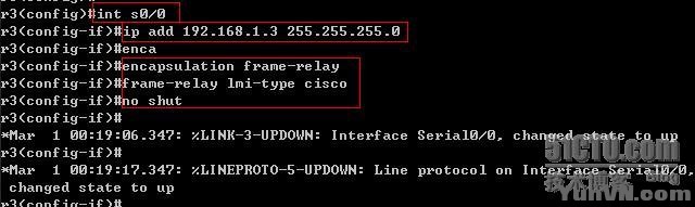

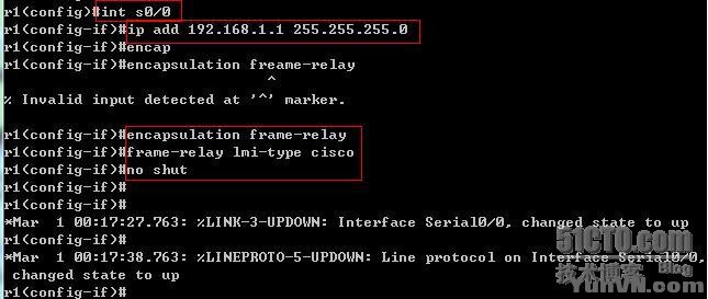

4.在R1、R2、R3路由器上配置接口IP,并封装为帧中继
  R1:
  R2:
  R3:

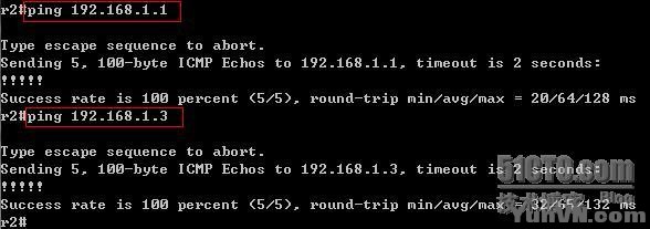

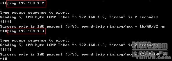

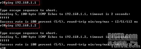

5.验证配置结果
  R1:
  R2:
  R3:
