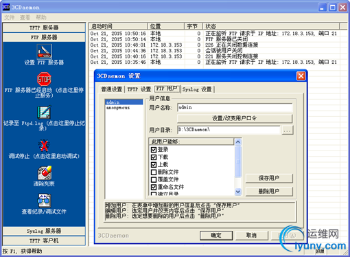

  • 学习3CDaemon FTP 服务器的配置和使用
  下载安装3CDaemon软件并配置FTP服务器部分
  • 设计应用以获取tcp报文
  使用3CDaemon 系统内置的匿名帐户 "anonymous"登陆FTP 服务器以获取TCP报文

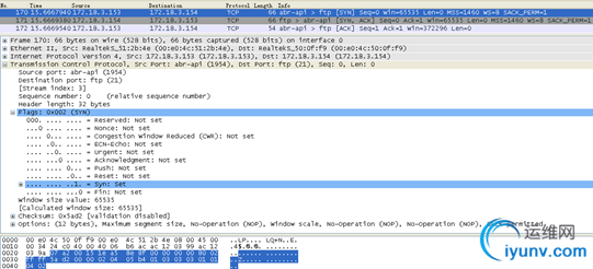

  (1)登录ftp服务器:172.18.3.154建立TCP连接的SYN报文:
  07a200151ea58e8f000000008002ffff5ad20000020405b40103030301010402
  源端口:07a2
  Source port: abr-api (1954)
  目的端口:0015
  Destination port: ftp (21)
  序号:1e a5 8e 8f
  Sequence number: 0 (relative sequence number)
  首部长度:8
  Header length: 32 bytes
  码元比特:02
  Flags: 0x002 (SYN)
  窗口:ff ff
  Window size value: 65535
  Calculated window size: 65535
  校验和:5ad2
  Checksum: 0x5ad2 [validation disabled]
  选项:02 04 05 b4 01 03 03 03 01 01 04 02
  Options: (12 bytes), Maximum segment size, No-Operation (NOP), Window scale, No-Operation (NOP), No-Operation (NOP), SACK permitted

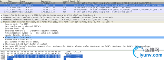

  (2)登录ftp服务器:172.18.3.154建立TCP连接的SYN+ACK报文:
  00e04c512b4e00e04c500ff9080045000034287040004006b2fcac12039aac120399001507a263bcdaf71ea58e908012ffff1c0d0000020405b40103030301010402 DSC0003.png
  源端口:00 15
  Source port: ftp (21)
  目的端口:07 a2
  Destination port: abr-api (1954)
  序号:63 bc da f7
  确认号:1e a5 8e 90
  Acknowledgment number: 1 (relative ack number)
  首部长度:8
  码元比特:12
  Flags: 0x012 (SYN, ACK)
  窗口:ff ff
  校验和:1c 0d
  Checksum: 0x1c0d [validation disabled]
  选项:020405b40103030301010402

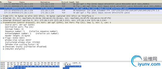

  (3)登录ftp服务器:172.18.3.154建立TCP连接的第二个ACK报文:
  07a200151ea58e9063bcdaf85010b5c9a7110000
  源端口:07a2
  目的端口:0015
  序号:1e a5 8e 90
  Sequence number: 1 (relative sequence number)
  确认号:63 bc da f8
  首部长度:5
  Header length: 20 bytes
  码元比特:10
  Flags: 0x010 (ACK)
  窗口:b5 c9
  Window size value: 46537
  Calculated window size: 372296
  Window size scaling factor: 8
  校验和:a7 11
  Checksum: 0xa711 [validation disabled]

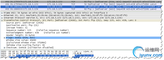

  (6)ftp服务器:172.18.3.154断开TCP连接的FIN seq =y ,ACK +1报文:
  0966001531de5386cb76f9c65011b59346cb0000
  源端口:09 66
  Source port: jediserver (2406)
  目的端口:00 15
  序号:31 de 53 86
  Sequence number: 135 (relative sequence number)
  确认号:cb 76 f9 c6
  Acknowledgment number: 438 (relative ack number)
  首部长度:5
  码元比特:11
  Flags: 0x011 (FIN, ACK)
  窗口:b5 93
  Window size value: 46483
  Calculated window size: 371864
  校验和:46 cb
  Checksum: 0x46cb [validation disabled]

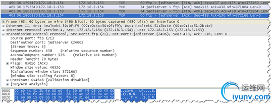

  (7)ftp服务器:172.18.3.154断开TCP连接的ACK y+1报文:
  00e04c512b4e00e04c500ff908004500002854fc40004006867cac12039aac12039900150966cb76f9c631de53875010b5b846a60000000000000000
  源端口:00 15
  目的端口:09 66
  Destination port: jediserver (2406)
  序号:cb 76 f9 c6
  Sequence number: 438 (relative sequence number)
  确认号:31 de 53 87
  Acknowledgment number: 136 (relative ack number)
  首部长度:5
  码元比特:10
  Flags: 0x010 (ACK)
  窗口:b5 b8
  Window size value: 46520
  Calculated window size: 372160
  校验和:46 a6
  Checksum: 0x46a6 [validation disabled]

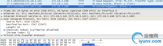

  2. 获取并分析UDP报文

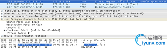

  (1)TFTP –i 172.18.3.188 GET f1.txt的第一个UDP报文:
  0c3e00450017bd5c
  源端口:0c 3e
  Source Port: 3134 (3134)
  目的端口:0045
  Destination Port: 69 (69)
  报文长度:00 17
  Length: 23
  校验和:bd 5c
  Checksum: 0xbd5c [validation disabled]
  数据为TFTP报文

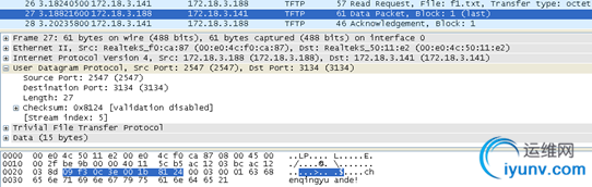

  (2)TFTP –i 172.18.3.188 GET f1.txt的第二个UDP报文:
  09f30c3e001b8124
  源端口:09 f3
  Source Port: 2547 (2547)
  目的端口:0c3e
  Destination Port: 3134 (3134)
  报文长度:00 1b
  Length: 27
  校验和:81 24
  Checksum: 0x8124 [validation disabled]
  数据为TFTP报文
  (3)TFTP –i 172.18.3.188 GET f1.txt的第三个UDP报文:
  0c3e09f3000c8a32
  源端口:0c 3e
  目的端口:09 f3
  Destination Port: 2547 (2547)
  报文长度:00 0c
  Length: 12
  校验和:8a 32
  Checksum: 0x8a32 [validation disabled]

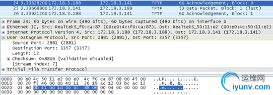

  (4)TFTP –i 172.18.3.188 PUT f2.txt的第一个UDP报文:
  0d1d00450017bc7b
  源端口:0d 1d
  Source Port: 3357 (3357)
  目的端口:00 45
  报文长度:00 17
  Length: 23
  校验和:bc 7b
  Checksum: 0xbc7b [validation disabled]
  数据为TFTP报文

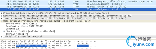

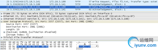

  (5)TFTP –i 172.18.3.188 PUT f2.txt的第二个UDP报文:
  0b410d1d000c8806
  源端口:0b 41
  Source Port: 2881 (2881)
  目的端口:0d 1d
  Destination Port: 3357 (3357)
  报文长度:00 0c
  Length: 12
  校验和:88 06
  Checksum: 0x8806 [validation disabled]
  数据为TFTP报文
  (6)TFTP –i 172.18.3.188 PUT f2.txt的第三个UDP报文:
  0d1d0b4100138b61
  源端口:0d 1d
  目的端口:0b 41
  Destination Port: 2881 (2881)
  报文长度:00 13
  Length: 19
  校验和:8b 61
  Checksum: 0x8b61 [validation disabled]
  数据为TFTP报文
