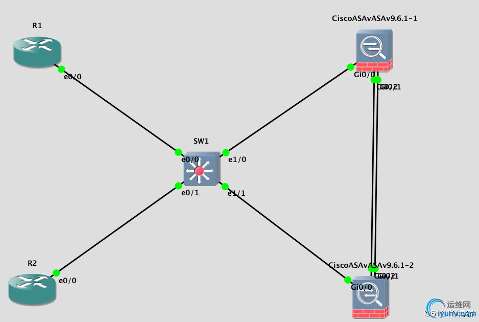

  In this article, I will briefly explain the active/standby failover configuration on the cisco ASA. The lab is done in GNS3.
  • Physical Topology:
  •   configuration:
