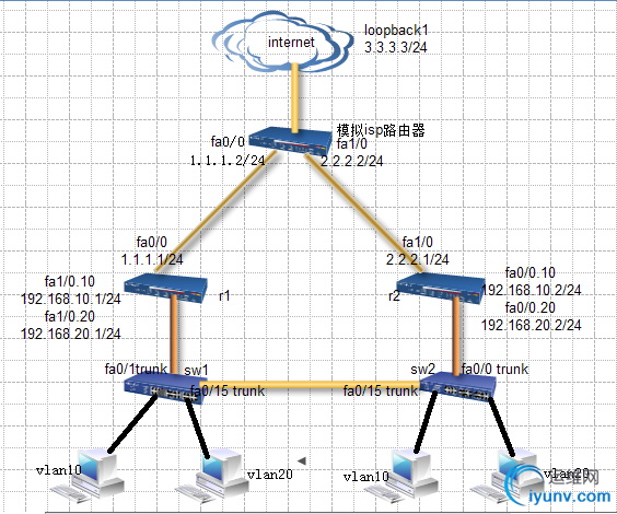

  HSRP:
  该协议中含有多台路由器,对应一个HSRP组。该组中只有一个路由器承担转发用户流量的职责,这就是活动路由器。当活动路由器失效后,备份路由器将承担该职责,成为新的活动路由器。这就是热备份的原理。
  我们通过一个小案例说明它的热备份原理。
  案例拓扑:
  实验原理:
  R1作为vlan10用户的的主路由器,即vlan10用户访问inter网时,数据都走r1通过,当r1坏掉时,vlan10用户的数据可以通过r2访问internet
  R2作为vlan20用户的的主路由器,即vlan20用户访问inter网时,数据都走r2通过,当r2坏掉时,vlan20用户的数据可以通过r1访问internet
  当然我们还可以在sw1和sw2之间做端口聚合,再做一次备份
  参考配置:
  r1# show run
  Building configuration...
  Current configuration : 1199 bytes
  version 12.4
  hostname r1
  interface FastEthernet0/0
  ip address 1.1.1.1 255.255.255.0
  ip nat outside(作为nat的外部端口)
  ip virtual-reassembly
  duplex auto
  speed auto
  interface FastEthernet1/0
  no ip address
  ip nat inside(nat的内部端口)
  duplex auto
  speed auto
  interface FastEthernet1/0.10(划分子接口)
  encapsulation dot1Q 10(封装dot1q)
  ip address 192.168.10.1 255.255.255.0
  ip nat inside
  standby 10 ip 192.168.10.254
  standby 10 priority 120(作为vlan10的主路由器)
  standby 10 preempt
  standby 10 track FastEthernet0/0 30(在fa0/0上做端口监听,若出现故障优先级减30)
  interface FastEthernet1/0.20(划分子接口)
  encapsulation dot1Q 20(封装dot1q)
  ip address 192.168.20.1 255.255.255.0
  ip nat inside
  standby 20 ip 192.168.20.254(r1为vlan20的备份路由器)
  ip http server
  no ip http secure-server
  ip route 0.0.0.0 0.0.0.0 1.1.1.2
  ip nat inside source list 1 interface FastEthernet0/0 overload(nat端口复用)
  access-list 1 permit any
  line con 0
  exec-timeout 0 0
  logging synchronous
  line aux 0
  line vty 0 4
  End
  r2#show run
  Current configuration : 1209 bytes
  version 12.4
  hostname r2
  no ip address
  ip nat inside(nat内部端口)
  shutdown
  duplex auto
  speed auto
  interface FastEthernet0/0.10(划分子接口)
  ip address 192.168.10.2 255.255.255.0
  ip nat inside
  standby 10 ip 192.168.10.254(r2作为vlan10的备份路由)
  interface FastEthernet0/0.20(划分子接口)
  ip address 192.168.20.2 255.255.255.0
  ip nat inside
  standby 20 priority 120(r2作为vlan10的主路由)
  standby 20 preempt
  standby 20 track FastEthernet1/0 30(在fa1/0上监听当路由器出现故障优先级降低30)
  ip address 2.2.2.1 255.255.255.0
  ip nat outside(nat外部端口)
  duplex auto
  speed auto
  ip route 0.0.0.0 0.0.0.0 2.2.2.2
  ip nat inside source list 1 interface FastEthernet1/0 overload(nat端口复用)
  line con 0
  exec-timeout 0 0
  logging synchronous
  line aux 0
  line vty 0 4
  End

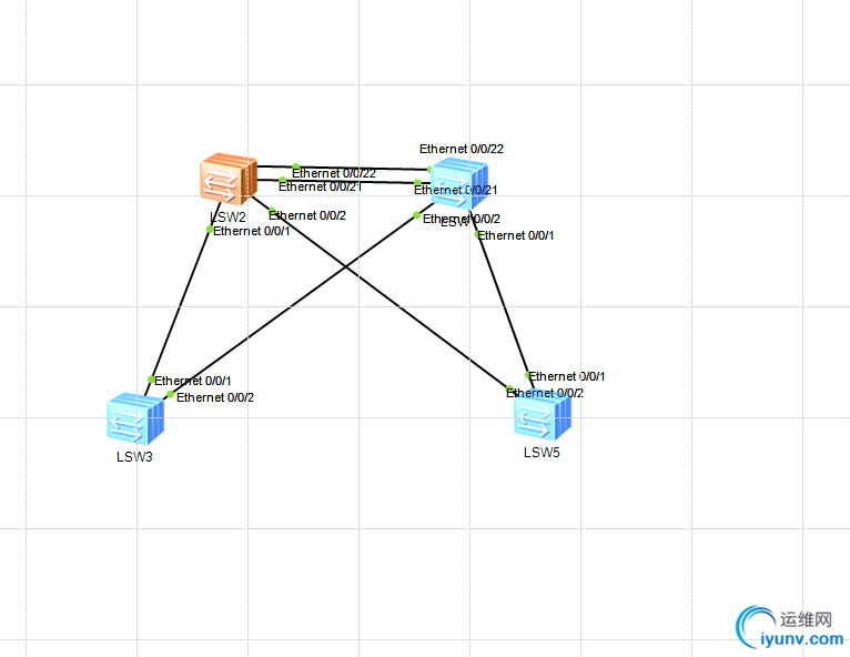

  VRRP:
  它是一种路由容错协议,也可以叫做备份路由协议。一个局域网络内的所有主机都设置缺省路由,当网内主机发出的目的地址不在本网段时,报文将被通过缺省路由发往外部路由器,从而实现了主机与外部网络的通信。当缺省路由器down掉(即端口关闭)之后,内部主机将无法与外部通信,如果路由器设置了VRRP时,那么这时,虚拟路由将启用备份路由器,从而实现全网通信。
  案例拓扑:
  实验原理:
  Sw1作为实例10的主路由器,来自vlan10和vlan20的数据以sw1为根选举阻塞端口
  Sw2作为实例10的主路由器,来自vlan30和vlan40的数据以sw2为根选举阻塞端口
  若主路由器发生故障,可以使用备份路由器进行数据转发
  参考配置:
  Sw1
  [Huawei-Vlanif40]
  [Huawei-Vlanif40]dis cu
  sysname Huawei
  vlan batch 10 20 30 40
  stp instance 10 root primary
  stp instance 20 root secondary
  cluster enable
  stp region-configuration
  region-name A
  revision-level 1
  instance 10 vlan 10 20
  instance 20 vlan 30 40
  active region-configuration
  interface Vlanif1
  interface Vlanif10
  vrrp vrid 10 virtual-ip 192.168.10.254
  vrrp vrid 10 priority 120
  vrrp vrid 20 virtual-ip 192.168.10.253
  interface Vlanif20
  vrrp vrid 21 virtual-ip 192.168.20.254
  vrrp vrid 22 virtual-ip 192.168.20.253
  vrrp vrid 22 priority 120
  interface Vlanif30
  ip address 192.168.30.1 255.255.255.0
  vrrp vrid 31 virtual-ip 192.168.30.254
  vrrp vrid 31 priority 120
  vrrp vrid 32 virtual-ip 192.168.30.253
  interface Vlanif40
  ip address 192.168.40.1 255.255.255.0
  vrrp vrid 41 virtual-ip 192.168.40.254
  vrrp vrid 42 virtual-ip 192.168.40.253
  vrrp vrid 42 priority 120
  interface Ethernet0/0/1
  port link-type trunk
  port trunk allow-pass vlan 2 to 4094
  interface Ethernet0/0/2
  [Huawei]dis vrrp brief
  VRIDStateInterfaceTypeVirtual IP
  10BackupVlanif10Normal192.168.10.253
  20MasterVlanif10Normal192.168.10.254
  21MasterVlanif20Normal192.168.20.253
  22BackupVlanif20Normal192.168.20.254
  31BackupVlanif30Normal192.168.30.253
  32MasterVlanif30Normal192.168.30.254
  41MasterVlanif40Normal192.168.40.253
  42BackupVlanif40Normal192.168.40.254
  Total:8Master:4Backup:4Non-active:0
