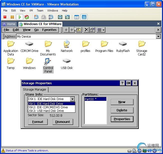

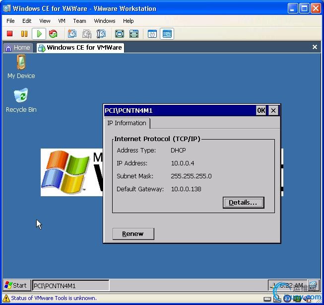

  VMWare虚拟的网卡兼容AMD PCnet-PCI II,具体型号是AMD AM79C970A,这个在Windows CE下可实在不好找,自己写一个就太麻烦了。不过在google大法的强力帮助下,我花了很长时间终于找到一个编译好的driver-还是for Windows CE 2.0的(现在想不起来在哪儿找到的了,想要的直接找我吧)。相关注册表设置见附录。
  比较头疼的是USB host driver。VMWare中支持的USB host controller是USB 1.1 UHCI controller。Windows CE下有现成的driver,但是直接拿来用的话你会发现不能工作。一番研究后发现问题出在LEGACY SUPPORT REGISTER (LEGSUP)的设置上-VMWare在初始化UHCI controller的时候enable了SMI generation,而且没有把USB中断route到PIRQD上。简单说来就是VMWare对UHCI controller的初始化和Windows CE自带driver要求的不一样(其实是和UHCI spec定义的不一致,UHCI  spec定义LEGSUP寄存器默认值是2000h(见5.2.1节),VMWare中是3Bh)。为了能让UHCI controller工作,需要修改UHCI  driver的初始化例程,重新编译一个版本。具体修改见附录。
  这样,一个支持声卡、网卡、USB设备的VMWare BSP就基本搞定了。
  附上两张运行时的截图:
  附1,网卡的注册表设置,放在platform.reg里:
[HKEY_LOCAL_MACHINECommPCNTN4M]
    "DisplayName"="PCNTN4M Compatible Ethernet Driver"
    "Group"="NDIS"
    "ImagePath"="pcntn4m.dll"
[HKEY_LOCAL_MACHINECommPCNTN4MLinkage]
    "Route"=multi_sz:"PCNTN4M1"
[HKEY_LOCAL_MACHINECommPCNTN4M1]
    "Group"="NDIS"
[HKEY_LOCAL_MACHINECommPCNTN4M1Parms]
;    "BusNumber"=dword:0
;    "BusType"=dword:05
;    "Interrupt"=dword:05
;    "IOAddress"=dword:0300
[HKEY_LOCAL_MACHINECommTcpipLinkage]
      "Bind"=multi_sz:"ppp","PCNTN4M1"
    ; Registry values for the pcntn4m1 driver
[HKEY_LOCAL_MACHINECommPCNTN4M1ParmsTcpIp]
    ; This enable the DHCP. In Win CE 2.1 Preview version statically allocated IP address
       ; does not work. So we use the DHCP server to allocate the IP address.
    "EnableDHCP"=dword:1
    ; This should be MULTI_SZ
    "DefaultGateway"=""
    ; This should be SZ... If null it means use LAN, else WAN and Interface.
    "LLInterface"=""
    ; Use zero for broadcast address? (or 255.255.255.255)
    "UseZeroBroadcast"=dword:0
    ; Thus should be MULTI_SZ, the IP address list
    "IpAddress"="0.0.0.0"
    ; This should be MULTI_SZ, the subnet masks for the above IP addresses
    "Subnetmask"="0.0.0.0"
; Template the PCI bus driver uses to match a AM79C970 PC-net card
[HKEY_LOCAL_MACHINEDriversBuiltInPCITemplatePCNTN4M]
   "Dll"="NDIS.dll"
   "Class"=dword:02
   "SubClass"=dword:00
   "ProgIF"=dword:0
   "VendorID"=multi_sz:"1022"
   "DeviceID"=multi_sz:"2000"
;  "Entry"="NdisPCIBusDeviceInit"
   "Prefix"="NDS"
   "Transceiver"=dword:3
   "IsrDll"="giisr.dll"
   "IsrHandler"="ISRHandler"
   "PortIsIO"=dword:1
   "PortOffset"=dword:C        ; TBD
   "PortSize"=dword:2
   "PortMask"=dword:5F00    ; TBD
[HKEY_LOCAL_MACHINECommConnectionSharing]
   "PrivateInterface"="PCI"PCNTN4M"
