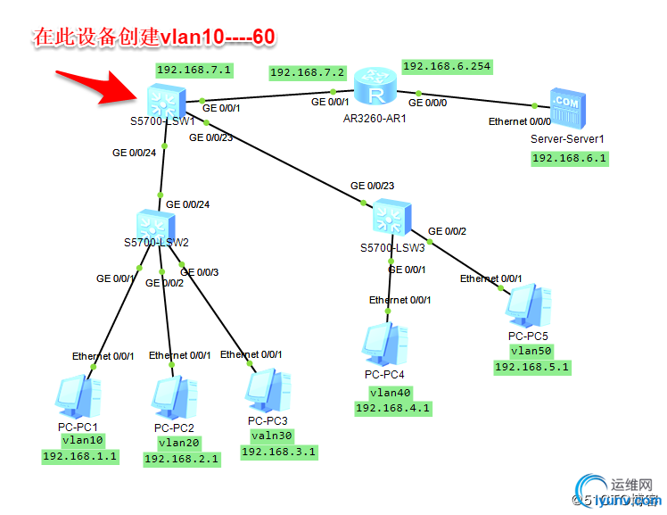

  华为三层交换机的配置
  先来看拓扑图
  下来看看配置过程
  SW2配置

  sw1配置
  <Huawei>sys
  [Huawei]sysname sw1           改名字
  [sw1]vlan batch 10 to 50     创建VLAN
  [sw1]int vlanif 10             给每个VLAN配置IP地址
  [sw1-Vlanif10]ip address 192.168.1.254 24
  [sw1-Vlanif10]int vlanif 20
  [sw1-Vlanif20]ip address 192.168.2.254 24
  [sw1-Vlanif20]int vlanif 30
  [sw1-Vlanif30]ip address 192.168.3.254 24
  [sw1-Vlanif30]int vlanif 40
  [sw1-Vlanif40]ip address 192.168.4.254 24
  [sw1-Vlanif40]int vlanif 50
  [sw1-Vlanif50]ip address 192.168.5.254 24
  [sw1-Vlanif50]q
  [sw1]int gi0/0/24                         此端口配置trunk模式
  [sw1-GigabitEthernet0/0/24]port link-type trunk
  [sw1-GigabitEthernet0/0/24]port trunk allow-pass vlan all
  [sw1-GigabitEthernet0/0/24]q
  [sw1]int gi0/0/23                         此端口配置trunk模式
  [sw1-GigabitEthernet0/0/23]port link-type trunk
  [sw1-GigabitEthernet0/0/23]port trunk allow-pass vlan all
  [sw1]vlan 60
  [sw1-vlan60]q
  [sw1]interface gi0/0/1
  [sw1-GigabitEthernet0/0/1]port link-type access
  [sw1-GigabitEthernet0/0/1]port default vlan 60
  [sw1-GigabitEthernet0/0/1]q
  [sw1]int vlanif 60
  [sw1-Vlanif60]ip address 192.168.7.1 24
  [sw1-Vlanif60]q
  [sw1]ip route-static 192.168.6.0 24 192.168.7.2   配置去往下一个网段的的下一跳
  路由器的配置
  每个端口配置IP地址
  在配置下一跳
  [Huawei]sysname R1
  [R1]interface gi0/0/1
  [R1-GigabitEthernet0/0/1]ip address 192.168.7.2 24
  [R1-GigabitEthernet0/0/1]q
  [R1]interface gi0/0/0
  [R1-GigabitEthernet0/0/0]ip address 192.168.6.254 24
  [R1-GigabitEthernet0/0/0]q
  [R1]ip route-static 0.0.0.0 0.0.0.0 192.168.7.1
  实验验证:华为交换机也可以当作三层设备来用它默认是开启的
  ip routing
