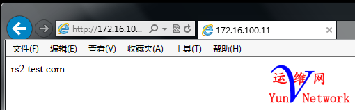

3.测试持久连接
[iyunv@master ~]# ipvsadm -L -n
IP Virtual Server version 1.2.1 (size=4096)
Prot LocalAddress:Port Scheduler Flags
  -> RemoteAddress:Port           Forward Weight ActiveConn InActConn
TCP  172.16.100.1:80 rr persistent 3600
  -> 172.16.100.10:80             Route   1      0          0
  -> 172.16.100.11:80             Route   1      0          37
大家可以看到,不断的刷新,请求始终在Real Server 2上! 说明,lvs持久连接 PPC 模式测试成功,下面我们继续

7.测试
[Shell] 纯文本查看 复制代码
FWM  8 rr persistent 600
  -> 172.16.100.10:0              Route   1      0          0
  -> 172.16.100.11:0              Route   1      0          102
从上面我们可以看出由于持久连接,我们始终访问在Real Server 2上,下面我们测试一下https效果,
