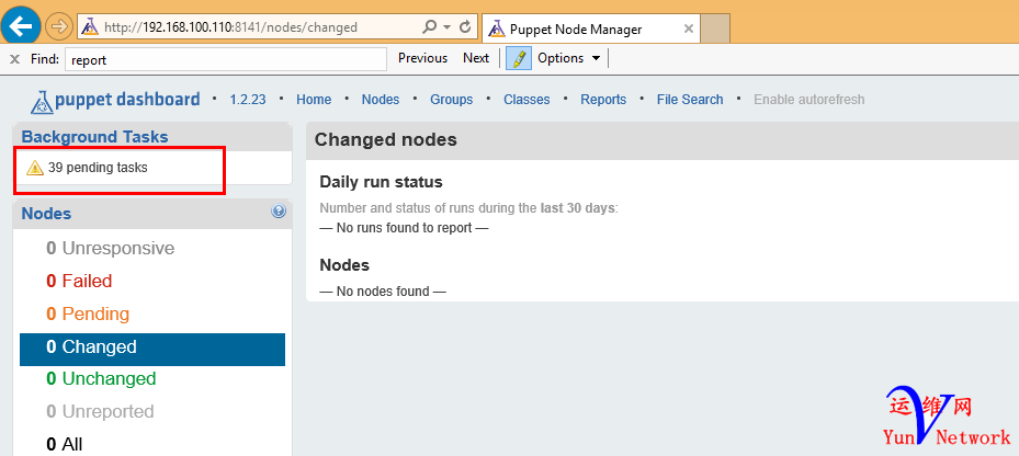

[iyunv@puppetserver public]# /etc/rc.d/init.d/httpd restart
6.3 开启后台处理报告进程
[iyunv@puppetserver puppet-dashboard]# rake RAILS_ENV=production jobs:work &  #运行“Delayed Job Workers”,使其在后台为我们处理报告日志
[1] 28651
[iyunv@puppetserver puppet-dashboard]# [Worker(host:puppetserver.kisspuppet.com pid:28651)] Starting job worker
[Worker(host:puppetserver.kisspuppet.com pid:28651)] Report.create_from_yaml_file completed after 0.2674
[Worker(host:puppetserver.kisspuppet.com pid:28651)] Report.create_from_yaml_file completed after 0.1725
[Worker(host:puppetserver.kisspuppet.com pid:28651)] Report.create_from_yaml_file completed after 0.1345
[Worker(host:puppetserver.kisspuppet.com pid:28651)] Report.create_from_yaml_file completed after 0.1772
[Worker(host:puppetserver.kisspuppet.com pid:28651)] Report.create_from_yaml_file completed after 0.1397
[Worker(host:puppetserver.kisspuppet.com pid:28651)] 42 jobs processed at 5.9487 j/s, 0 failed ...

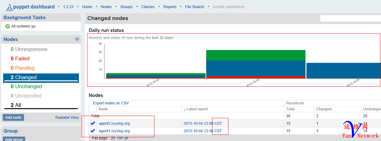

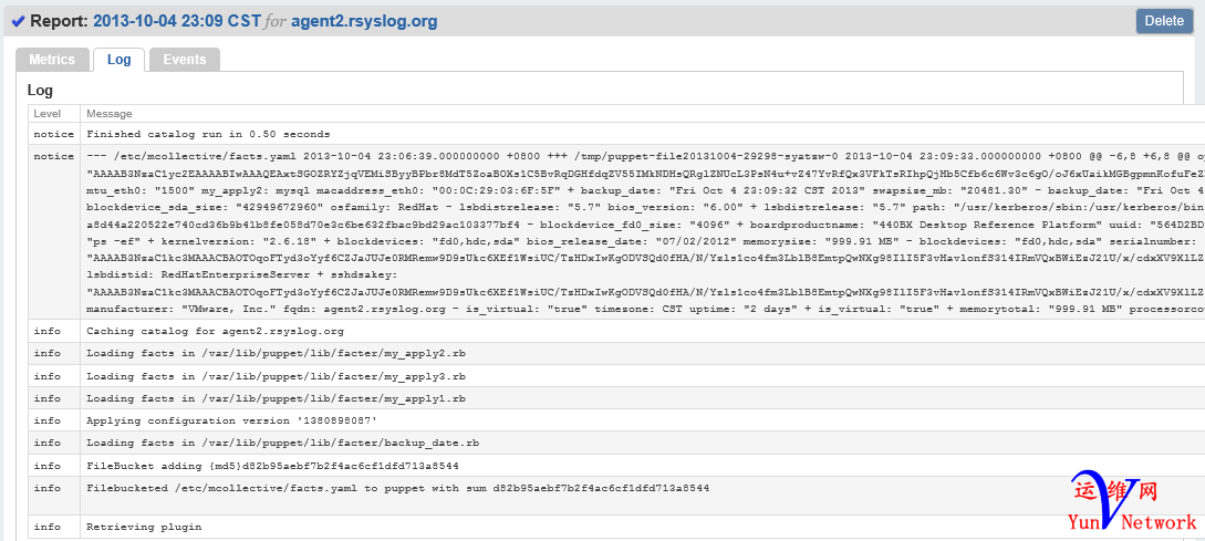

6.5 显示报告
通过http://192.168.100.110:8141/ 及时查看节点更新的报告信息,可以看到两个节点agent1和agent2,默认显示时间为CST格式,除此之外还可以看到某一个节点在某一个时刻的更新报告和运行曲线图。
