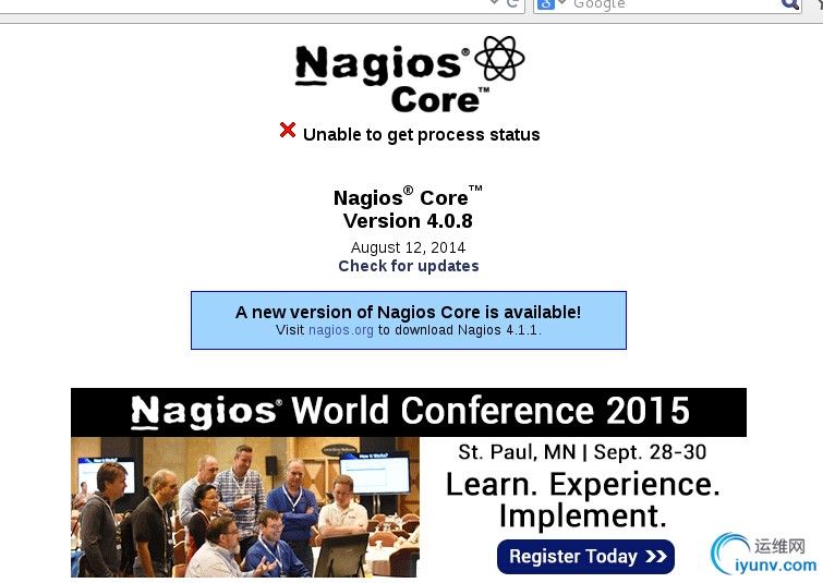

第一次装nagios,在笔记本虚拟机上做实验,打开主页后报这个错误,想请各路高手指点下。

把selinux关闭了,临时关闭setenforce 0,永久关闭需要重启vim /etc/selinux/config
状态改成disabled
发表于 2015-8-28 09:45:19 | 显示全部楼层
I had this problem as well. Try the selinux suggestion above. When things don’t work and you did everything right with no errors, for me 9 times out of 10 the problem is selinux. I try to remember to try this first now.

ok了,谢谢谢谢
