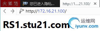

  [iyunv@node15 ~]# vim /var/www/html/index.html
  <h1>RS1.stu21.com</h1>
  3.启动httpd
  [iyunv@node15 ~]# service httpd start
  4.测试
  5.设置开机自启动
  [iyunv@node15 ~]# chkconfig httpd on

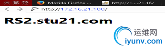

  [iyunv@node16 ~]# vim /var/www/html/index.html
  <h1>RS2.stu21.com</h1>
  3.启动httpd
  [iyunv@node16 ~]# service httpd start
  4.测试
  5.设置开机自启动
  [iyunv@node16 ~]# chkconfig  httpd on
  [iyunv@node16 ~]# chkconfig --list  httpd
  httpd              0:off    1:off    2:on    3:on    4:on    5:on    6:off

  7.测试

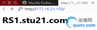

  (3).测试一下

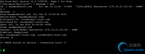

  (4).查看一下邮件
  [iyunv@node17 ~]# mail

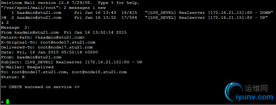

  (7).再查看一下邮件

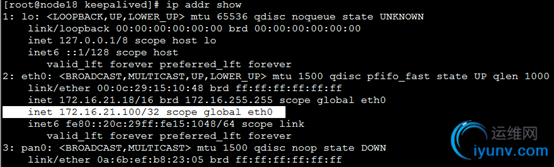

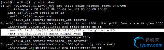

  (9).查看一下slave状态
  [iyunv@node18 ~]# ip addr show
  1: lo: <LOOPBACK,UP,LOWER_UP> mtu 65536 qdisc noqueue state UNKNOWN
  link/loopback 00:00:00:00:00:00 brd 00:00:00:00:00:00
  inet 127.0.0.1/8 scope host lo
  inet6 ::1/128 scope host
  valid_lft forever preferred_lft forever
  2: eth0: <BROADCAST,MULTICAST,UP,LOWER_UP> mtu 1500 qdisc pfifo_fast state UP qlen 1000
  link/ether 00:0c:29:15:10:48 brd ff:ff:ff:ff:ff:ff
  inet 172.16.21.18/16 brd 172.16.255.255 scope global eth0
  inet 172.16.21.100/32 scope global eth0
  inet6 fe80::20c:29ff:fe15:1048/64 scope link
  3: pan0: <BROADCAST,MULTICAST> mtu 1500 qdisc noop state DOWN
  link/ether 0a:6b:ef:b8:23:05 brd ff:ff:ff:ff:ff:ff
  You have new mail in /var/spool/mail/root

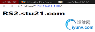

  (10).再次测试一下

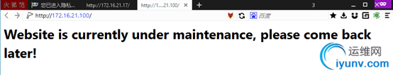

  • 问题:在集群中如果所有real server全部宕机了,客户端访问时就会出现错误页面,这样是很不友好的,我们得提供一个维护页面来提醒用户,服务器正在维护,什么时间可以访问等,下面我们就来解决一下这个问题。解决方案有两种,一种是提供一台备用的real server当所有的服务器宕机时,提供维护页面,但这样做有点浪费服务器。另一种就是在负载均衡器上提供维护页面,这样是比较靠谱的,也比较常用。下面我们就来具体操作一下。
  (1).master(node17)与slave(node18)安装上httpd
  [iyunv@node17 ~]# yum -y install httpd
  [iyunv@node18 ~]# yum -y install httpd
  (2).配置维护页面
  [iyunv@node17 ~]# vim /var/www/html/index.html
  Website is currently under maintenance, please come back later!
  [iyunv@node18 ~]# vim /var/www/html/index.html
  (3).启动httpd服务并测试
  [iyunv@node17 ~]# service httpd start
  Starting httpd:                                            [  OK  ]
  [iyunv@node18 ~]# service httpd start
  (4).修改配置文件

  (5).关闭所有的real server并重新启动一下master与slave的keepalived
  [iyunv@node15 ~]# service httpd stop
  Stopping httpd:                                            [  OK  ]
  [iyunv@node16 ~]# service httpd stop
  [iyunv@node17 ~]#  service keepalived restart
  Stopping keepalived:                                       [  OK  ]
  Starting keepalived:                                       [  OK  ]
  [iyunv@node18 ~]#  service keepalived restart
  (6).查看一下lvs
  [iyunv@node17 ~]# ipvsadm -L -n
  IP Virtual Server version 1.2.1 (size=4096)
  Prot LocalAddress:Port Scheduler Flags
    -> RemoteAddress:Port           Forward Weight ActiveConn InActConn
  TCP  172.16.21.100:80 rr
    -> 127.0.0.1:80                 Local   1      0          0
  (7).测试
  注,sorry_server测试成功,下面我们继续。

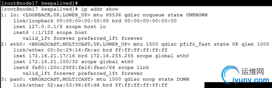

  (4).测试
  [iyunv@node17 ~]# cd /etc/keepalived/
  [iyunv@node17 keepalived]# touch down
  [iyunv@node17 keepalived]# ll
  total 8
  -rw-r--r-- 1 root root    0 Jan 16 15:14 down
  -rw-r--r-- 1 root root 4330 Jan 16 15:10 keepalived.conf
  [iyunv@node17 keepalived]# ip add show #查看VIP
  [iyunv@node18 ~]# ip addr show #查看一下VIP已转移到slave上
  测试:我再把 /etc/keepalived/ 目录下的down 文件移除或是改变
  [iyunv@node17 keepalived]# mv down down.bak
  total 8
  -rw-r--r-- 1 root root    0 Jan 16 15:14 down.bak
  [iyunv@node17 keepalived]# ip addr show #查看一下VIP又回到master上
  好了,自写监测脚本,完成维护模式切换,到这里就演示成功,下面我们来解决最后一个问题,就是keepalived主从切换的邮件通告。
  11.如何在keepalived故障时(或主备切换时),发送警告邮件给指定的管理员?
      [iyunv@node17 keepalived]#touch down #进入维护模式
      [iyunv@node18 keepalived]# ip addr show   #大家可以看到VIP成功移动到slave上
      在有vip的节点上查看一下邮件:
      [iyunv@node18 keepalived]# mail
      主备切换时,会发送邮件报警,好了到这里所有演示全部完成。

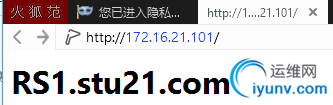

      接下来测试一下:
      VIP=172.16.21.100 实现高可用
      VIP=172.16.21.101 实现高可用
