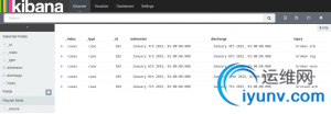

  We can open a browser and head to localhost:5601 to open the Kibana web interface. Log in as Alice:
  After logging in, Kibana will ask for the index pattern. We'll keep it simple:
  Then in the discover tab you can add fields to your view. Notice that Alice only sees cases:
  When we log in as Bob our discover tab shows both cases and patients:
