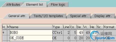

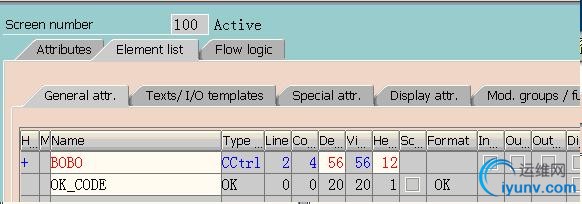

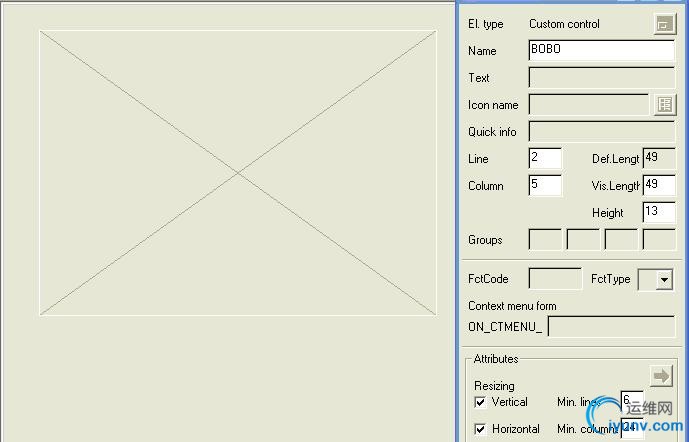

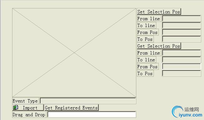

  5.2.1 定义一个屏幕100
  5.2.2 在100上放一个container,名字为bobo
  5.2.3 设置一个pf-status,定义一个退出function key
  5.2.4 添加一个ok_code

  1).在前面定义的屏幕上加一个输出字段,以显示事件类型

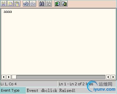

  5).测试程序效果
  双击之后:

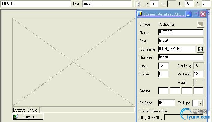

  我们以set_text_as_r3table为例介绍一下具体的步骤:
  1).在前面的例子的屏幕上放置一个按钮,名字IMPORT,OK_CODE:IMP

  method load_text.
  call method add_data exporting ind = '1'.
  * Load TextEdit control with texts
  CALL METHOD text_editor->set_text_as_r3table
  EXPORTING table = i_texttab.
  IF sy-subrc > 0.
  * Display an error message
  EXIT.
  ENDIF.
  * All methods that operates on controls are transferred to the frontend
  * by a RFC calls. the method FLUSH is used to determine when this is don
  CALL METHOD cl_gui_cfw=>flush.
  IF sy-subrc > 0.
  ENDIF.
  endmethod.
  method load_events.
  call method add_data exporting ind = '2'.
  call method cl_gui_cfw=>flush.
  endmethod.

  定义OK_CODE处理

  5.5.2 GET_SELECTION_POS和SET_SELECTION_POS
  定义屏幕字段:
  定义数据:
  data:
  fline type i,
  tline type i,
  fpos type i,
  tpos type i,
  gfline type i,
  gtline type i,
  gfpos type i,
  gtpos type i.
  处理ok_code:
  when 'SSP'.
  CALL METHOD text_editor->SET_SELECTION_POS
  EXPORTING
  FROM_LINE = fline
  FROM_POS = fpos
  TO_LINE = tline
  TO_POS = tpos
  EXCEPTIONS
  ERROR_CNTL_CALL_METHOD = 1
  others = 2
  when 'GSP'.
  CALL METHOD text_editor->GET_SELECTION_POS
  IMPORTING
  FROM_LINE = gfline
  FROM_POS = gfpos
  TO_LINE = gtline
  TO_POS = gtpos
  EXCEPTIONS
  others = 2
  5.5.3 SET_READONLY_MODE
  这个方法设置text editor为只读模式,你在创建好text editor之后调用就可以。
  CALL METHOD TEXT_EDITOR->SET_READONLY_MODE
  EXPORTING
  READONLY_MODE = 1 “0:可以修改 1:只读
  EXCEPTIONS
  INVALID_PARAMETER = 2
  others = 3 .

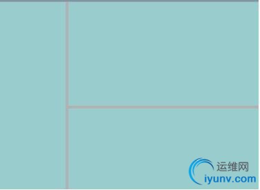

  效果如图:
  Space:
  ‘X’:

  6.2.1 创建屏幕,定义一下ok_code就可以了

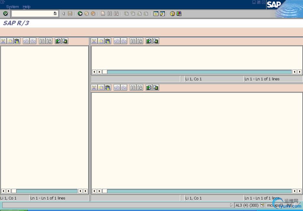

  6.2.5 测试结果如图:

  我们把整个屏幕都分了,那么能不能我们只分割一个customer_container呢?
  答案是当然可以,我们首先放一个customer container到屏幕上,然后创建custom container,然后在此基础上分割custom container.
  创建屏幕:
  添加代码:
