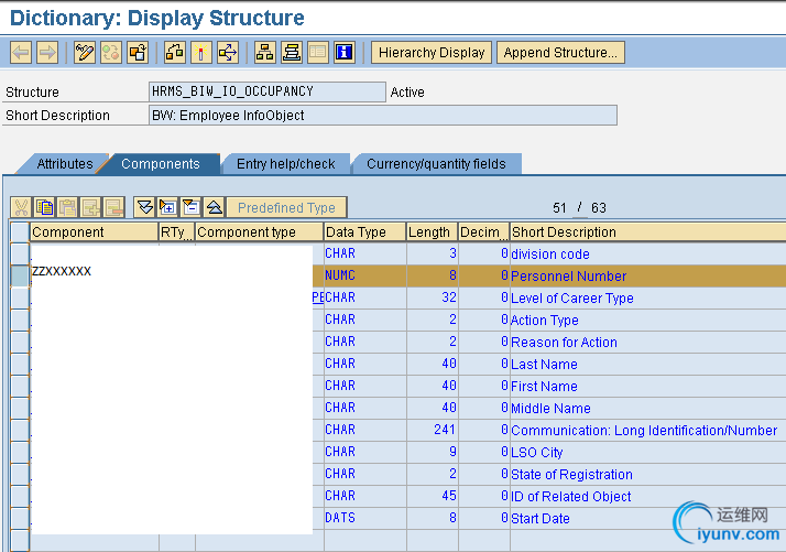

Enhancing 0EMPLOYEE to bring supervisor information:
    Go to transaction RSA2 in ECC side. Enter the datasource name and click Display.
  Go to extraction tab and double click the extract structure
  Click on append structure option and add the new InfoObjectZZXXXXXX to the extract structure
  Go to transaction CMOD in R/3 side and enhance the extractor 0employee_attr for filling the ZZXXXXXX field which was a custom field added to the original extract structure.
  Enhance the code for 0employee_attr in the above highlighted SAP Exit

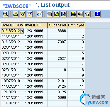

Storing Employee-Supervisor information in a DSO
  Creating hierarchy structure was a challenging requirement, so we decided to have the most critical Employee-Supervisor information in a write-optimized DSO. This was required to facilitate the dynamic access of this WDSO to create Supervisor hierarchy structure rather than focusing on establishing employee-supervisor relation at run time.
  In WDSO we needed Employee & Supervisor information. Since Supervisor is a time dependent attribute of 0employee master data so VALIDFROM & VALIDTO dates becomes critical and was thus included in the WDSO.
  Direct mapping was done between Attribute of 0employee and WDSO ZWDSO08.

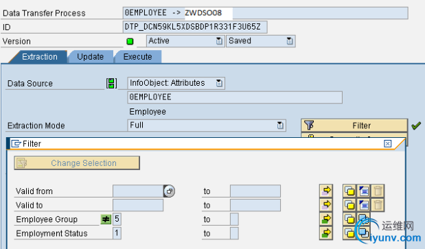

DTP Filters
  Employment Status and Employee Group are two important attributes in term of reducing the no of records loaded to DSO ZWDSO08.
  1.     Employee Group = 5 signifies retired employees & they could be excluded to reduce the record count to this DSO.
  2.     Employment Status = 1(inactive) & 3(active) employees. We can restrict Employment Status to either 1 or 2, as these are the two employment status we         are interested in.
  3.     VALIFROM <= sy-datum
         A dynamic DTP filter routine is written to implement this.
  4.     VALIDTO >= sy-datum

DSO Containing Hierarchy Data
  In the initial stages we already learnt that how we are enhancing the 0employee extractor to bring the additional employee-supervisor information and storing it in a DSO ZWDSO08 for deriving the hierarchy structure. For a similar requirement you can use a master or transaction datasource and get data in a DSO of your choice. Data can be loaded to this DSO from a simple flat file as well.
  A dummy data set to show the kind of data this DSO ZWDSO08 holds

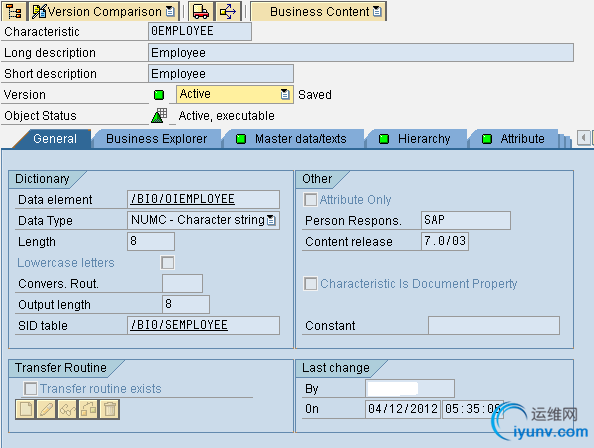

InfoObject for activating hierarchy
  Properties of this InfoObject needs to be edited to suit for this particular requirement. Check for following settings:-
  • Maintain the InfoObject as an ‘InfoSource with Direct Update'.
  • Choose an application component after enabling corresponding check box.
  • Mark the InfoObject as an InfoProvider and assign it to an InfoArea. Now the InfoObject would be visible in InfoProvider tree in Data Warehousing Workbench.
  • Enable the InfoObject as an export data source. This allows the extraction of the InfoObject data using data mart interface.
  • Check the hierarchy’s check box to specify that InfoObject contains hierarchies.

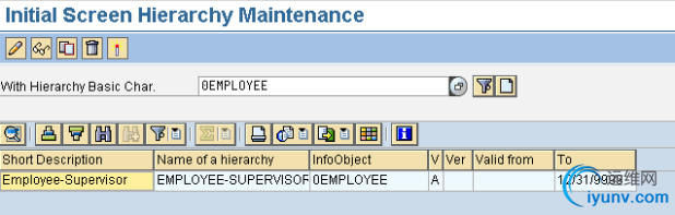

Activating hierarchy by creating a dummy node
  InfoObject settings are correctly maintained and activated. To activate the hierarchy we need to create a dummy hierarchy node which would be the first step towards generating custom hierarchy. Creation of dummy node would have to be done only once manually.
  Right Click on the hierarchies and choose the Maintain Hierarchy option
  Click on create button to create a dummy hierarchy with requisite description.
  Create a simple text node by choosing text node out of available options at the top.
  A dummy hierarchy is created and it looks like this

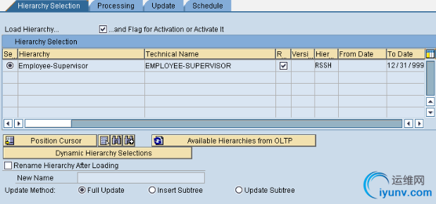

Creating an InfoPackage
    Create a new InfoPackage for the hierarchy datasource by right-clicking on the datasource and selecting ‘Create InfoPackage' option. Refresh the ‘available hierarchies from OLTP'. This will load all hierarchies that are available in the source. As we only created a dummy hierarchy, this will be the only hierarchy we can extract. Select this dummy hierarchy and save the InfoPackage

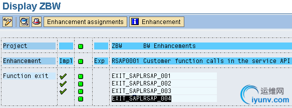

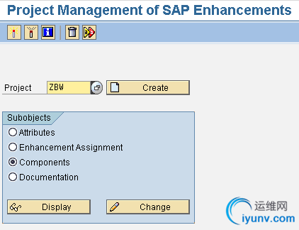

  Go to transaction CMOD, give your project name and choose the‘Components’ radio button and click on Display
  Hierarchy datasources can be enhanced like any other type of datasource. Enhancement "RSAP0001 - Customer function calls in the service API” is called automatically during extraction. We have different exits for Transaction, Master & Text, Hierarchies.
  • EXIT_SAPLRSAP_001: Transactional data
  • EXIT_SAPLRSAP_002: Master data attributes or texts
  • EXIT_SAPLRSAP_004: Hierarchies
  If enhancement RSAP0001 is not yet active in your system, it can be activated and assigned to a project.
  The function module ‘EXIT_SAPLRSAP_004' is called every time a hierarchy datasource is executed. This function module contains an include  ‘ZXRSAU04'. This include can be enhanced using ABAP code to fetch the data from the DSO we loaded earlier. The most important table in this exit is table C_T_HIENODE which should be filled with the actual hierarchy data. Do not forget to refresh the C_T_HIENODE before inserting any data to delete the text node created for activating the Hierarchy.
