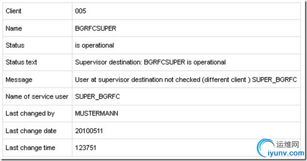

  次项功能由程序SRT_ADMIN_CHECK来执行.此程序检查WebService运行所需的所有各项设置,并返回状态,所需检查的各项设置如下:
  • Supervisor destination with attributes (client/tenant of registration, name, status [soastage:operational/ not operational], status text, (error) message text (if any), name of user, user name of last change, date of last change, time of last change).
  • Example:
