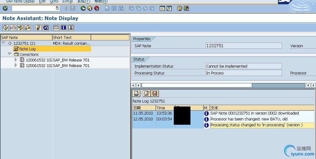

  The Note Assistant (transaction SNOTE) helps you to implement SAP OSS notes. Although itis not perfect it does generally make the application of OSS notes a much easier process. Noteassistant is at its best when all that is required is a simple code deletion/insertion into an existingABAP object. If the object does not exists then you will be required to do the creation bit manually,note assistant will then be able to insert the ABAP code.
Another benefit of SAP note assistant is that it automatically prompts you to implement anyprerequisite notes that apply.
Note assistants biggest problem comes when updates have been provided bySAP but not forgeneral release (i.e. a specific fix for your company) or you have modified standard SAP code. Ifnote assistant tries to update an object which has been changed using this method then itmay have trouble inserting the code in the correct place.
Implementing an OSS note via SAP note assistant
The table below outlines the simple steps required to implement an OSS note using SAPnote assistant (SNOTE).
StepIconDescription
1 DSC0000.png or DSC0001.png Download note (differnt icon depending on your version of SAP)
2 DSC0002.png Set process status to ‘in process’
3 DSC0003.png Read note instructions
4 DSC0004.png Implement note (popup will appear allowing you to read note)
5 DSC0005.png View implementation log, add comments of your own
6 DSC0006.png Set status to ‘complete’
Other icons
DSC0008.png De-implement note
DSC0009.png Note browser (view all in system for your user)
DSC00010.png Download latest version of SAP notes
