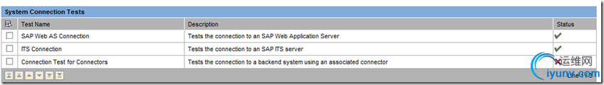

  When above steps are done, proceed to the connect tests. The WAS test and ITS test will pass while connector test will fail.
  For connector test, single sign on is needed. After configure SSO for portal and backend, test will pass.
