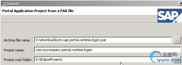

2) Import the PAR file into Netweaver Developer Studio:
- Select File>Import .
- Choose the option PAR file. Select Next and a popup window appears.
- In the window you have 3 text fields: The location of the par file, a project name (which will also be the new par file name) and the location where the project should be saved. The project name should differ from the original SAP file to avoid overwriting of the original. It also works as a security blanket, in case you have an exception in your custom logon code or want to start from scratch again.
