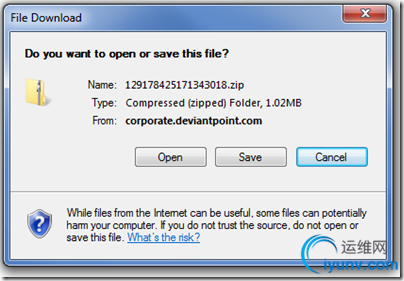

  The user has selected some documents and a sub-folder so my custom ribbon button is enabled:
  The user clicks on this button and this feature executes and after it&#8217;s complete the user is prompted with this (note, the filename is a timestamp):
