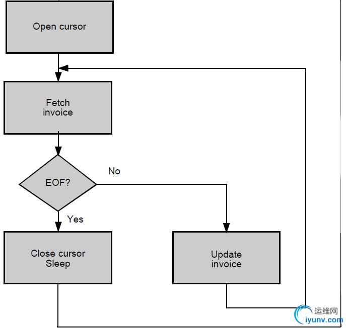

Suppose that you have a system to process new invoices. The invoices are stored in a
table, and a column called PROCESSED indicates unprocessed invoices. An
application processes these new invoices and updates the PROCESSED column to
show they have been processed. After all the invoices have been processed, the
application tries to fetch another unprocessed invoice and receives an end-of-file
condition.
Without publish/subscribe services, this process is more costly. To retrieve new
invoices that are inserted into the table after the end-of-file condition, the application
must close its cursor and reopen it, perhaps after waiting an interval, to see if new
invoices have arrived. This polling requires the closing and reopening of the cursor,
which has significant performance costs. It also requires application code to handle the
looping and end-of-file conditions.
