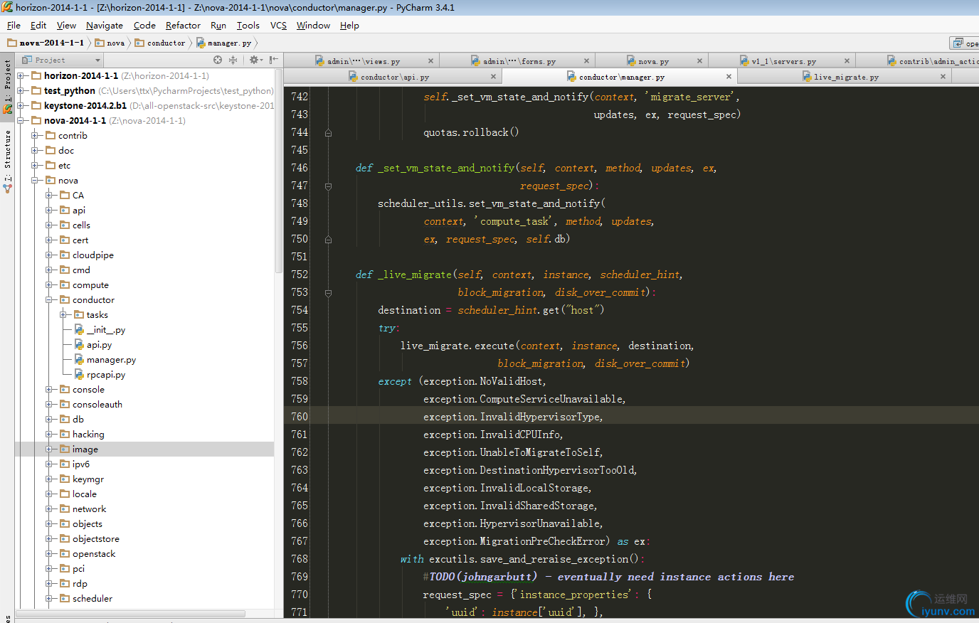

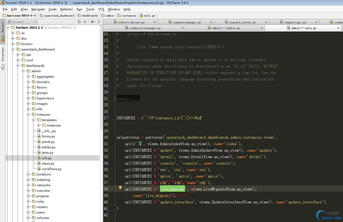

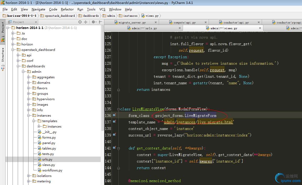

附上代码:判断冷迁移还是热迁移逻辑:
        if live and not rebuild and not flavor:
            self._live_migrate(context, instance, scheduler_hint,
                               block_migration, disk_over_commit)
        elif not live and not rebuild and flavor:
            instance_uuid = instance['uuid']
            with compute_utils.EventReporter(context, self.db,
                                         'cold_migrate', instance_uuid):
                self._cold_migrate(context, instance, flavor,
                                   scheduler_hint['filter_properties'],
                                   reservations)

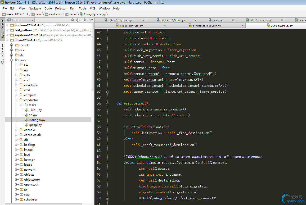

conductor调用conpute的代码:

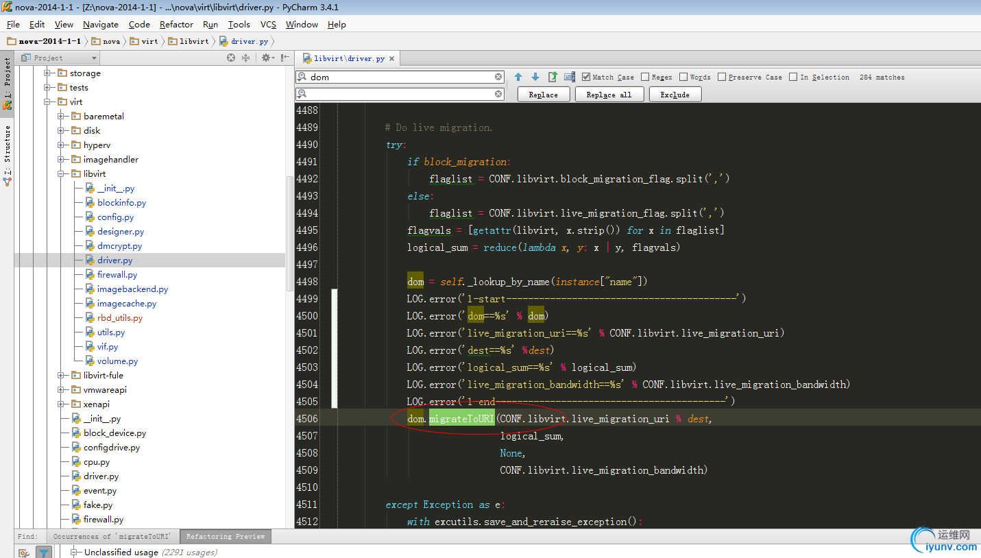

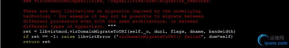

错误报在migrateToURI函数,打印输出参数:
vim /usr/lib/python2.6/site-packages/nova/virt/libvirt/driver.py
def _live_migration(self, context, instance, dest, post_method,
                        recover_method, block_migration=False,
                        migrate_data=None):
        """Do live migration.
        :param context: security context
        :param instance:
            nova.db.sqlalchemy.models.Instance object
            instance object that is migrated.
        :param dest: destination host
        :param post_method:
            post operation method.
            expected nova.compute.manager.post_live_migration.
        :param recover_method:
            recovery method when any exception occurs.
            expected nova.compute.manager.recover_live_migration.
        :param block_migration: if true, do block migration.
        :param migrate_data: implementation specific params
        # Do live migration.
        try:
            if block_migration:
                flaglist = CONF.libvirt.block_migration_flag.split(',')
            else:
                flaglist = CONF.libvirt.live_migration_flag.split(',')
            flagvals = [getattr(libvirt, x.strip()) for x in flaglist]
            logical_sum = reduce(lambda x, y: x | y, flagvals)

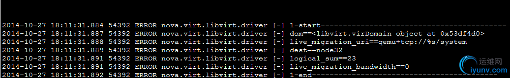

            dom = self._lookup_by_name(instance["name"])
            LOG.error('1-start------------------------------------------')
            LOG.error('dom==%s' % dom)
            LOG.error('live_migration_uri==%s' % CONF.libvirt.live_migration_uri)
            LOG.error('dest==%s' %dest)
            LOG.error('logical_sum==%s' % logical_sum)
            LOG.error('live_migration_bandwidth==%s' % CONF.libvirt.live_migration_bandwidth)
            LOG.error('1-end------------------------------------------')
            dom.migrateToURI(CONF.libvirt.live_migration_uri % dest,
                             logical_sum,
                             None,
        except Exception as e:
            with excutils.save_and_reraise_exception():
                LOG.error(_("Live Migration failure: %s"), e,
                          instance=instance)
                recover_method(context, instance, dest, block_migration)

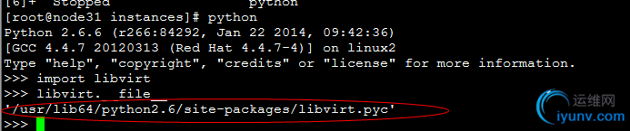

从上述打印日志可以看出dom值为libvirt.virtDomain对象:
/usr/lib64/python2.6/site-packages/libvirt.py
在能正常迁移的fule节点上面打印上述日志:

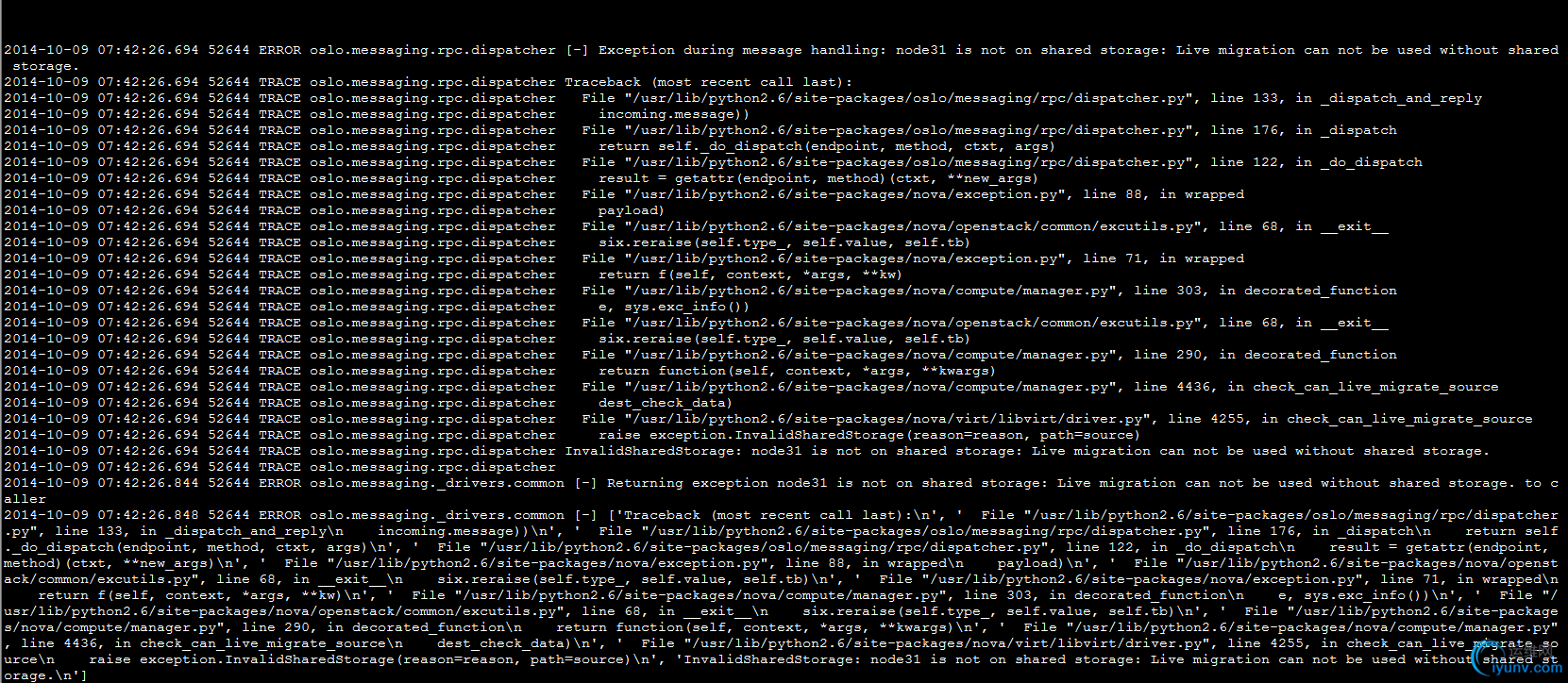

找到文件:
/usr/lib/python2.6/site-packages/nova/virt/libvirt/driver.py", line 4255, in check_can_live_migrate_source
https://blueprints.launchpad.net/nova/+spec/live-migration-to-conductor

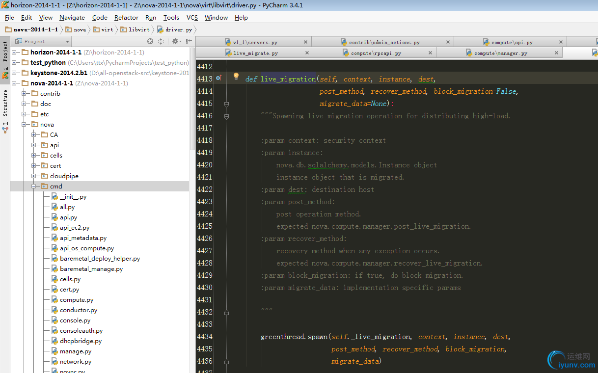

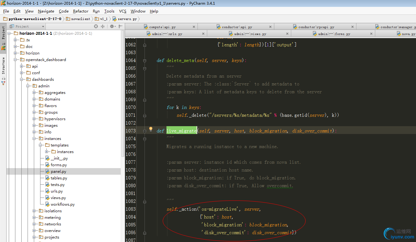

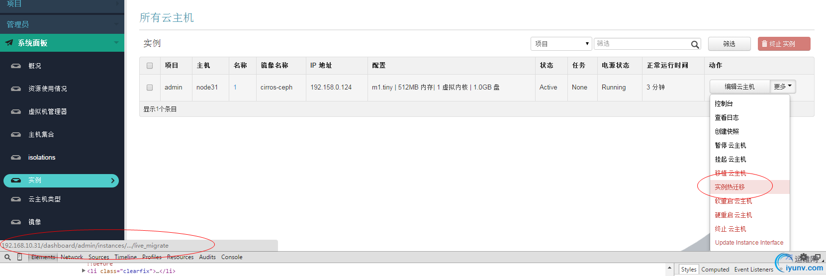

由上述可知:live_migrate的执行流程为:dashboard->novaclient->nova-api->nova-conductor->nova-compute->virt.libvirt.driver.py.
从上图打印的值,可以看出is_volume_backed:False,似乎有bug,继续跟踪下去。
查看fule对应处的输出:
上述两处的差别在于,fuel代码中传递了image_type==rbd参数。(其实,在nova.conf配置文件中会配置,images_type=rbd项,因此不需要传递参数,自己根据配置文件修改即可。)

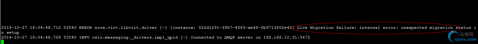

日志说明是在 dom.migrateToURI函数执行后异常错误(即调用libvirt出异常)。
打印fuel代码:
日志打印一致,则说明在之前步骤中,原生nova没有pre-create文件夹。
用fule代码:
说明在 dom.migrateToURI()之前自动创建了文件夹。
