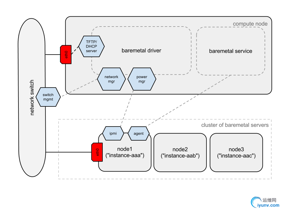

Bare-metal provisioning framework architecture
Our driver implements the standard driver interface for the OpenStack hypervisor driver, with the difference that it doesn’t actually talk to any hypervisor. Instead it manages a pool of physical nodes. Each physical node could be used to provision only one“Virtual” (sorry for the pun) Machine (VM) instance. When a new provisioning request arrives, the driver chooses a physical host from a pool to place this VM on and it stays there until destroyed. The operator can add, remove, and modify the physical nodesin the pool.
bare-metal provisioning architecture
The main components related to the bare-metal provisioning support are:
  • nova-computewith the bare-metal driver: The bare-metal driver itself consists of several components:
    • The power manager is responsible for operations such as setting boot devices, powering up and down nodes, etc. It’s robust enough to support several management protocol implementations (we developed two, based on IPMIoool and FreeIPMI to support a widerrange of hardware).
    • The network manager interacts with the rack switch and is responsible for switching nodes back and forth between the service and projects’ networks (the service network is used to deploy the bare-metal instance via PXE/TFTP). Currently we have an implementationfor the Juniper switches. More details on that will be provided in another post devoted to networking support.
    • dnsmasq is a Netboot environment for instance provisioning.
  • nova-baremetal-agent: This is the agent that is supposed to be run onbootstrap-linux (see the next bullet) and executes various provisioning tasks spawned by the bare-metal driver.
  • bootstrap-linux: A tiny Linux image to be booted over the network and perform basic initialization. It is based on theTiny Core Linux andcontains a basic set of packages such as Python to runnova-baremetal-agent (which is implemented in Python) and curl to be able to download an image from Glance. Additionally, it contains an init script that downloads nova-baremetal-agent usingcurl and executes it.
  • nova-baremetal-service: A service that is responsible for orchestration of the provisioning tasks (tasks are applied by nova-baremetal-agent directly to the bare-metal server it is running on).

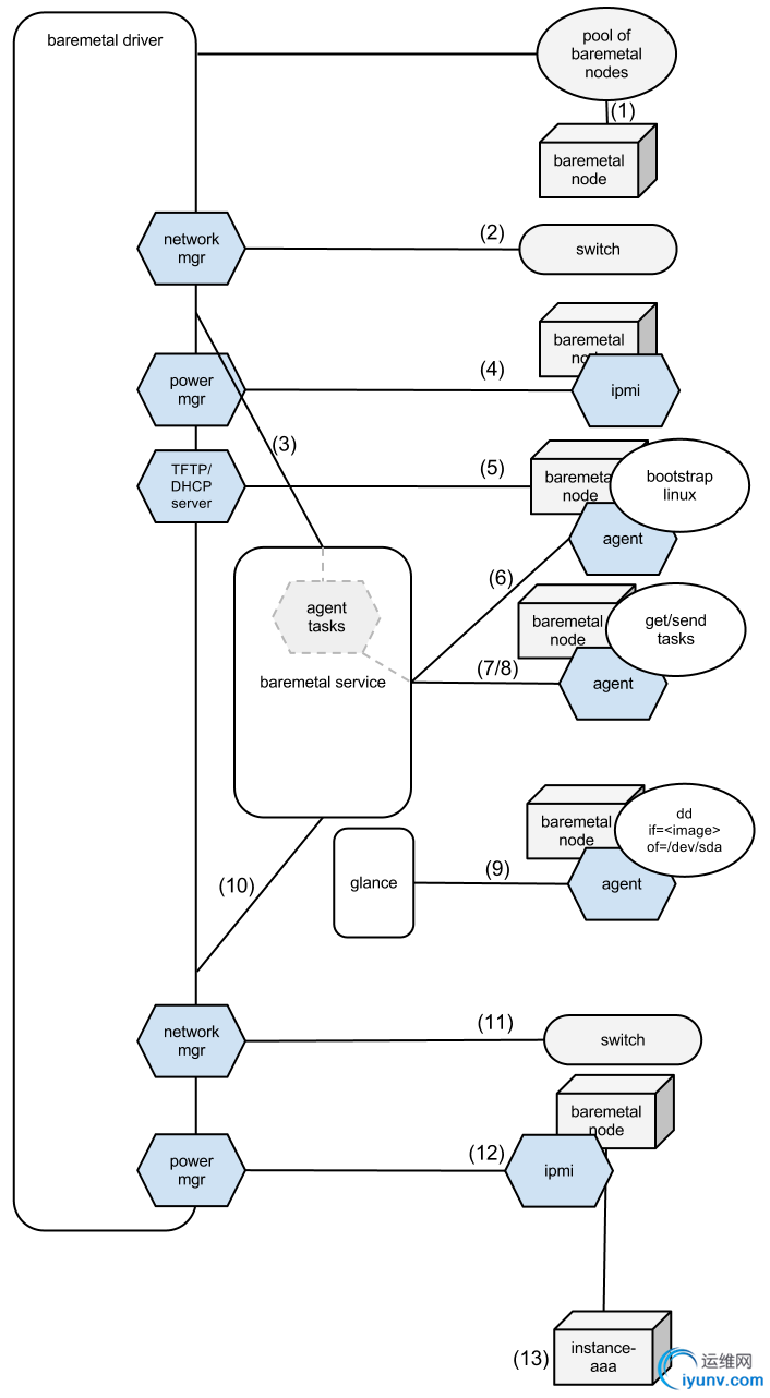

Let’s see what each component actually does in the course of provisioning a new VM (i.e., when you callnova boot). I won’t focus on the details of this request until it reachesnova-compute and the spawn request has reached our bare-metaldriver.
The following diagram illustrates this workflow:
bare-metal provisioning flow
  • The driver chooses a free physical node from the pool.
  • It’s plugged into the service network (there is a detailed blog post on networking forthcoming, so I will skip that for now).
  • The driver places a spawn task for the agent, which contains all the necessary information, such as what image to boot from.
  • The driver issues IPMI commands to enable network boot for a node and power it up.
  • Bootstrap Linux boots over the network from an image served by dnsmasq.
  • Bootstrap Linux initialization scripts fetch an agent code from nova-baremetal-service (which provides a REST interface for that).
  • nova-baremetal-agent polls the nova-baremetal-service REST service for tasks.
  • nova-baremetal-service sees a task for this node and sends a response with the task, which includes a URL for the image from Glance and the authentication token to be able to fetch it.
  • nova-baremetal-agent fetches an image from the URL specified in the task and ‘dd’s it to the hard drive and then informsnova-baremetal-service that it’s done with the task.
  • As soon as nova-baremetal-service is notified about task completion, it informs the driver that it’s time to reboot the node.
  • The driver sees that the provisioning is almost complete, so it switches network to the project’s network.
  • It sets booting from the hard drive and reboots the node.
  • The node is up.
