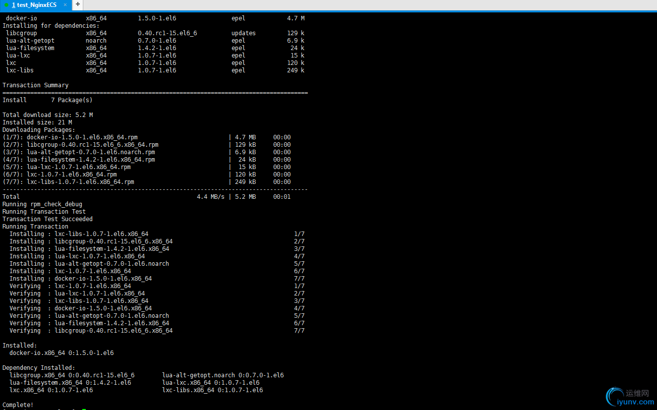

[iyunv@iZ25gswv4olZ /]# sudo yum install http://mirrors.yun-idc.com/epel/6/i386/epel-release-6-8.noarch.rpm
[iyunv@iZ25gswv4olZ /]# sudo yum install docker-io

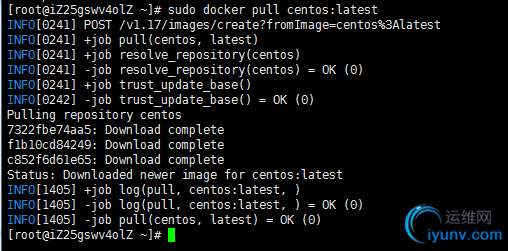

测试使用-我们需要下载最新的centos镜像
注意:由于 Aliyun 的网络直接 pull 官方镜像也不是很稳定,可选择官方标准镜像来测试
[iyunv@iZ25gswv4olZ ~]# sudo docker pull centos:latest
它将会输出如下的信息:
INFO[0623] POST /v1.17/images/create?fromImage=centos%3Alatest
INFO[0623] +job pull(centos, latest)
INFO[0623] +job resolve_repository(centos)
INFO[0623] -job resolve_repository(centos) = OK (0)
INFO[0623] +job trust_update_base()
INFO[0624] -job trust_update_base() = OK (0)
Pulling repository centos
7322fbe74aa5: Download complete
f1b10cd84249: Download complete
c852f6d61e65: Download complete
INFO[0855] +job log(pull, centos:latest, )
INFO[0855] -job log(pull, centos:latest, ) = OK (0)
INFO[0855] -job pull(centos, latest) = OK (0)
Status: Downloaded newer image for centos:latest

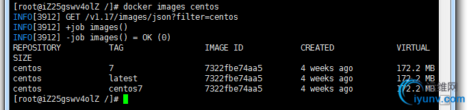

  下一步,我们要确保通过如下命令可以看到镜像运行情况:
[iyunv@iZ25gswv4olZ /]# docker images centos
它将会输出如下的信息:
INFO[3912] GET /v1.17/images/json?filter=centos
INFO[3912] +job images()
INFO[3912] -job images() = OK (0)
REPOSITORY          TAG                 IMAGE ID            CREATED             VIRTUAL SIZE
centos              7                   7322fbe74aa5        4 weeks ago         172.2 MB
  centos              latest              7322fbe74aa5        4 weeks ago         172.2 MB
  centos              centos7             7322fbe74aa5        4 weeks ago         172.2 MB
