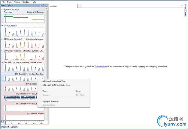

Determining the cause of a stop 0x133 with a first parameter of 1 is a bit more difficult because the problem is a result of DPCs running from multiple drivers, so the call stack is insufficientto determine the culprit.  To troubleshoot this stop, first make sure that the NT Kernel Logger or Circular Kernel Context Logger ETW traces are enabled on the system.  (For directions on setting this up, seehttp://blogs.msdn.com/b/ntdebugging/archive/2009/12/11/test.aspx.)
Once the logging is enabled and the system bug checks, dump out the list of ETW loggers using !wmitrace.strdump. Find the ID of the NT Kernel logger or the Circular logger.  You can then use!wmitrace.logsave (ID) (path to ETL) to write out the ETL log to a file.  Load it up with Windows Performance Analyzer and add the DPC or DPC/ISR Duration by Module, Function view (located in the Computation group) to your current analysis window:
Next, make sure the table is also shown by clicking the box in the upper right of the view:

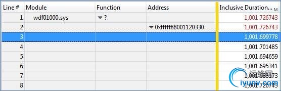

Ensure that the Address column is added on the left of the gold bar, then expand each address entry to see individual DPC enters/exits for each function.  Using this data, you can determinewhich DPC routines took the longest by looking at the inclusive duration column, which should be added to the right of the gold bar:
In this case, these DPCs took 1 second, which is well over the recommended maximum of 100 us.  The module column (and possible the function column, if you have symbols) will show which driveris responsible for that DPC routine.  Since our ECHO driver was based on WDF, that is the module named here.
