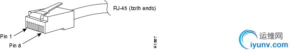

Figure 5 shows the 100BASE-TX RJ-45 connector, and Table 6 lists its pinouts. The 1-port Fast Ethernet network module RJ-45 port actively terminates wire pair 4 and 5 and wire pair 7 and 8. Common-mode termination reduces electromagnetic interference (EMI) and susceptibility to common-mode sources.
图五 所示的为 100BASE-TX RJ-45 连接器,表6列出了它的管脚。1个快速以太网模块RJ-45只要将4、5线对和7、8线对连接即可激活。通常的连接方式可以减弱电磁干扰。
Figure 5 100BaseTX RJ-45 Connector
Table 6 RJ-45 Connector Pinout
