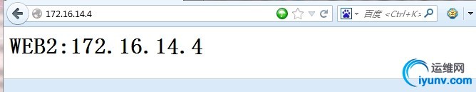

3、安装WEB2服务器的HTTPD服务并访问测试
[iyunv@WEB2~]# yum -y install httpd
[iyunv@WEB2~]# service httpd start
[iyunv@WEB2~]# chkconfig httpd on
[iyunv@WEB2~]# echo "<h1>WEB2:172.16.14.4</h1>" >/var/www/html/index.html
