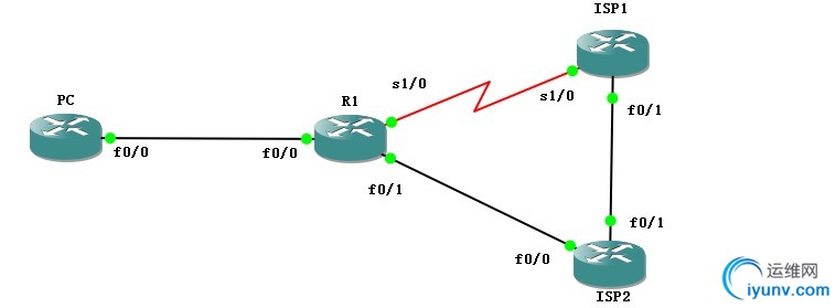

    实验一、策略路由当作ACL使用
    PC1配置:
    PC1#conf t
    PC1(config)#no ip routing
    PC1(config)#ip default-gateway 192.168.0.1
    PC1(config)#int fa0/0
    PC1(config-if)#ip add 192.168.0.101 255.255.255.0
    PC1(config-if)#no sh
    PC1(config-if)#exit
    PC2配置:
    PC2#conf t
    PC2(config)#no ip routing
    PC2(config)#ip default-gateway 192.168.0.1
    PC2(config)#int fa0/0
    PC2(config-if)#ip add 192.168.0.102 255.255.255.0
    PC2(config-if)#no sh
    PC2(config-if)#exit
    Internet配置:
    Internet#conf t
    Internet(config)#int fa0/0
    Internet(config-if)#ip add 202.100.100.100 255.255.255.0
    Internet(config-if)#no sh
    Internet(config-if)#exit
    Internet(config)#ip route 192.168.0.0 255.255.255.0202.100.100.1
    R1配置:
    R1#conf t
    R1(config)#int fa0/0
    R1(config-if)#ip add 192.168.0.1 255.255.255.0
    R1(config-if)#no sh
    R1(config-if)#exit
    R1(config)#int fa0/1
    R1(config-if)#ip add 202.100.100.1 255.255.255.0
    R1(config-if)#no sh
    R1(config-if)#exit
    R1(config)#access-list 1 permit host 192.168.0.101 //ACL标记流量
    R1(config)#route-map internet permit 10 //创建路由图
    R1(config-route-map)#match ip address 1 //设置匹配ACL流量
    R1(config-route-map)#set interface null0 //对符合的流量设置下一跳接口为null0,即掉弃
    R1(config-route-map)#exit
    R1(config-if)#ip policy route-map internet //将路由图应用到接口
    R1(config-if)#exit
    测试检查:
    PC1#ping 202.100.100.100
    Type escape sequence to abort.
    Sending 5, 100-byte ICMP Echos to 202.100.100.100,timeout is 2 seconds:
    Success rate is 0 percent (0/5)
    PC2#ping 202.100.100.100
    Success rate is 100 percent (5/5), round-trip min/avg/max= 20/40/108 ms
    R1#debug ip policy
    Policy routing debugging is on
    *Mar  100:15:57.371: IP: s=192.168.0.101 (FastEthernet0/0), d=202.100.100.100, len100, FIB policy match
    *Mar  100:15:57.371: IP: s=192.168.0.101 (FastEthernet0/0), d=202.100.100.100 (Null0),len 100, FIB policy routed(drop)
    *Mar  100:15:57.527: IP: s=192.168.0.102 (FastEthernet0/0), d=202.100.100.100, len100, FIB policy rejected(no match) - n                                            ormal forwarding
    *Mar  100:15:57.619: IP: s=192.168.0.102 (FastEthernet0/0), d=202.100.100.100, len100, FIB policy rejected(no match) - normal forwarding
    实验二、基于源地址的路由策略
  • S1配置:
    S1#conf t
    S1(config)#int fa0/0
    S1(config-if)#ip add 192.168.11.11 255.255.255.0
    S1(config-if)#no sh
    S1(config-if)#exit
    S1(config)#router ospf 1
    S1(config-router)#net 192.168.11.0 0.0.0.255 area 0
    S1(config-router)#exit
    S2配置:
    S2#conf t
    S2(config)#int fa0/1
    S2(config-if)#ip add 192.168.22.22 255.255.255.0
    S2(config-if)#no sh
    S2(config-if)#exit
    S2(config)#router ospf 1
    S2(config-router)#net 192.168.22.0 0.0.0.255 area 0
    S2(config-router)#exit
    ISP1配置:
    ISP1#conf t
    ISP1(config)#int fa0/0
    ISP1(config-if)#ip add 100.100.100.100 255.255.255.0
    ISP1(config-if)#no sh
    ISP1(config-if)#exit
    ISP1(config)#int fa0/1
    ISP1(config-if)#ip add 12.12.12.1 255.255.255.0
    ISP1(config)#router ospf 1
    ISP1(config-router)#net 100.100.100.0 0.0.0.255 area 0
    ISP1(config-router)#net 12.12.12.0 0.0.0.255 area 0
    ISP1(config-router)#exit
    ISP2配置:
    ISP2#conf t
    ISP2(config)#int fa0/0
    ISP2(config-if)#ip add 200.200.200.200 255.255.255.0
    ISP2(config-if)#no sh
    ISP2(config-if)#exit
    ISP2(config)#int fa0/1
    ISP2(config-if)#ip add 12.12.12.2 255.255.255.0
    ISP2(config)#router ospf 1
    ISP2(config-router)#net 200.200.200.0 0.0.0.255 area 0
    ISP2(config-router)#net 12.12.12.0 0.0.0.255 area 0
    ISP2(config-router)#exit
    R1配置:
    R1#conf t
    R1(config-if)#ip add 192.168.11.1 255.255.255.0
    R1(config-if)#no sh
    R1(config-if)#exit
    R1(config-if)#ip add 192.168.22.1 255.255.255.0
    R1(config-if)#no sh
    R1(config-if)#exit
    R1(config)#int fa1/0
    R1(config-if)#ip add 100.100.100.1 255.255.255.0
    R1(config-if)#no sh
    R1(config-if)#exit
    R1(config)#int fa2/0
    R1(config-if)#ip add 200.200.200.1 255.255.255.0
    R1(config-if)#no sh
    R1(config-if)#exit
    R1(config)#router ospf 1
    R1(config-router)#net 0.0.0.0 255.255.255.255 area 0
    R1(config-router)#exit
    R1(config)#access-list 11 permit 192.168.11.0 0.0.0.255//ACL11标记192.168.11.0的流量
    R1(config)#access-list 22 permit 192.168.22.0 0.0.0.255//ACL22标记192.168.22.0的流量
    R1(config)#route-map s1 permit 10 //创建路由图s1,允许流量
    R1(config-route-map)#match ip address 11 //匹配ACL11的流量
    R1(config-route-map)#set ip next-hop 100.100.100.100//对匹配ACL11的流量直接转发到ISP1
    R1(config)#route-map s1 deny 20 //路由图S1拒绝其他所有流量
    R1(config)#route-map s2 permit 10//创建路由图S2,允许流量
    R1(config-route-map)#match ip address 22//匹配ACL22的流量
    R1(config-route-map)#set ip next-hop 200.200.200.200//ACL22的流量直接转发到ISP2
    R1(config)#route-map s2 deny 20//路由图S2拒绝其他所有流量
    R1(config-if)#ip policy route-map s1 //在接口下应用路由图S1
    R1(config-if)#exit
    R1(config-if)#ip policy route-map s2//在接口下应用路由图S2
    R1(config-if)#exit

实验四、基于报文长度的策略路由
PC配置:
PC#conf t
PC(config)#no ip routing
PC(config)#ip default-gateway 192.168.0.1
PC(config)#int fa0/0
PC(config-if)#ip add 192.168.0.101 255.255.255.0
PC(config-if)#no sh
PC(config-if)#exit
ISP1配置:
ISP1#conf t
ISP1(config)#int s1/0
ISP1(config-router)#net 0.0.0.0 255.255.255.255 area 0
ISP2配置:
ISP2(config-router)#net 0.0.0.0 255.255.255.255 area 0
R1配置:
R1#conf t
R1(config-if)#no sh
R1(config-if)#exit
R1(config-if)#no sh
R1(config-if)#exit
R1(config)#int s1/0
R1(config-if)#no sh
R1(config-if)#exit
R1(config-if)#router ospf 1
R1(config)#route-map smallsize permit 10 //定义报文长度的路由图
R1(config-route-map)#match length 0 1000 //匹配报文长度为最小1 最大1000
R1(config-route-map)#set interface s1/0 //从符合条件的报文全部走s1/0接口
R1(config)#route-map smallsize permit 20//在路由图中设置其他报文的流量全部走fa0/1
R1(config-route-map)#set interface fa0/1
R1(config-if)#ip policy route-map smallsize
R1(config-if)#exit
检查测试:
PC#ping 12.12.12.1 size 1400
Sending 5, 1400-byte ICMP Echos to 12.12.12.1, timeout is2 seconds:
Success rate is 100 percent (5/5), round-trip min/avg/max= 92/108/128 ms
PC#ping 12.12.12.1 size 1000
Sending 5, 1000-byte ICMP Echos to 12.12.12.1, timeout is2 seconds:
Success rate is 100 percent (5/5), round-trip min/avg/max= 76/88/108 ms
R1#debug ip policy
*Mar  100:23:58.611: IP: s=192.168.0.101 (FastEthernet0/0), d=12.12.12.1, len 1400,FIB policy match
*Mar  100:23:58.611: IP: s=192.168.0.101 (FastEthernet0/0), d=12.12.12.1(FastEthernet0/1), len 1400, FIB policy routed
*Mar  100:23:58.767: IP: s=192.168.0.101 (FastEthernet0/0), d=12.12.12.1, len 1400,FIB policy match
*Mar  100:23:58.767: IP: s=192.168.0.101 (FastEthernet0/0), d=12.12.12.1(FastEthernet0/1), len 1400, FIB policy routed
*Mar  100:25:19.135: IP: s=192.168.0.101 (FastEthernet0/0), d=12.12.12.1 (Serial1/0),len 1000, FIB policy routed
*Mar  100:25:19.211: IP: s=192.168.0.101 (FastEthernet0/0), d=12.12.12.1, len 1000, FIBpolicy match
*Mar  100:25:19.211: fibidb->namestring: Serial1/0
*Mar  100:25:19.211: ipfib_policy_set_interface_lookup: tag_ptr: 0x0
*Mar  100:25:19.211: adj 0x0, NULL

R1(config-ip-sla-echo)#frequency 5//设置任务SLA1每隔5s执行一次
R1(config-ip-sla-echo)#exit
R1(config)#ip sla schedule 1 life forever start-time now//设置任务SLA1马上执行
R1(config)#track 1 rtr 1 reachability//使用track 追踪SLA1,检查线路的可达性
R1(config-track)#exit
R1(config)#ip sla 2//创建SLA 任务2
R1(config-ip-sla)#icmp-echo 200.200.200.2 source-ip200.200.200.200//设置任务SLA2,用200.200.200.200去ping ISP2
R1(config-ip-sla-echo)#timeout 1200//每个包发出去多长时间还没收到就代表失败,单位毫秒
R1(config-ip-sla-echo)#frequency 5//设置任务SLA2每隔5s执行一次
R1(config)#ip sla schedule 2 life forever start-time now//设置任务SLA2马上执行
R1(config)#track 2 rtr 2 reachability//使用track追踪SLA2,检查线路的可达性
R1(config)#route-map isp-working permit 10//创建路由图isp-working,用于不同线路分配流量
R1(config-route-map)#match ip address isp1//匹配去往isp1网段的流量
R1(config-route-map)#set ip next verify-availability100.100.100.1 1 track 1//追踪ISP1的可达性,如果可达,则设置匹配的流量走ISP1线路,否则这条语句不生效,并执行下一语句。
R1(config-route-map)#set ip next verify-availability200.200.200.2 2 track 2//追踪ISP2的可达性,如果可达,则设置匹配的流量走ISP2线路,否则这条语句不生效,并执行下一语句。
R1(config)#route-map isp-working permit 20
R1(config-route-map)#match ip address isp2 //匹配去往ISP2网段的流量
R1(config-route-map)#set ip next verify-availability200.200.200.2 1 track 2//追踪ISP2的可达性,如果可达,则设置匹配的流量走ISP2线路,否则这条语句不生效,并执行下一语句。
R1(config-route-map)#set ip next verify-availability100.100.100.1 2 track 1//追踪ISP1的可达性,如果可达,则设置匹配的流量走ISP1线路,否则这条语句不生效,并执行下一语句。
R1(config)#route-map isp-working permit 30//处理其他既不是去往ISP1也不是去往ISP2的流量。
R1(config-route-map)#match ip address foreign
R1(config)#route-map nat-isp1 permit 110//创建NAT条件路由图nat-isp1,匹配当ISP1线路正常,去往ISP1网段且从fa0/1出去的流量
R1(config-route-map)#match interface fa0/1
R1(config)#route-map nat-isp11 permit 110//创建NAT条件路由图nat-isp11,匹配当ISP1线路断掉,去往ISP1网段且从fa1/0出去的流量
R1(config-route-map)#match interface fa1/0
R1(config)#route-map nat-isp2 permit 110//创建NAT条件路由图nat-isp2,匹配当ISP2线路正常,去往ISP2网段且从fa1/0出去的流量
R1(config)#route-map nat-isp22 permit 110//创建NAT条件路由图nat-isp22,匹配当ISP2线路断掉,去往ISP2网段且从fa0/1出去的流量
R1(config)#route-map nat-foreign1 permit 220//创建NAT条件路由图nat-foreign1,匹配选择ISP1为出口,且既不是ISP1也不是ISP2的流量
R1(config)#route-map nat-foreign2 permit 220//创建NAT条件路由图nat-foreign2,匹配选择ISP2为出口,且既不是ISP1也不是ISP2的流量
R1(config)#ip nat inside source route-map nat-isp1interface fa0/1 overload//当ISP1线路正常,且去往ISP1网段时就转换
R1(config)#ip nat inside source route-map nat-isp11interface fa1/0 overload//当ISP1线路断掉,而ISP2线路正常,且又是去往ISP1网段时就转换,备用
R1(config)#ip nat inside source route-map nat-isp2interface fa1/0 overload//当ISP2线路正常,且去往ISP2网段时就转换
R1(config)#ip nat inside source route-map nat-isp22interface fa0/1 overload////当ISP2线路断掉,而ISP1线路正常,且又是去往ISP2网段时就转换,备用
R1(config)#ip nat inside source route-map nat-foreign1interface fa0/1 overload//如果ISP1线路正常,其他非去往ISP1或ISP2的流量,且从fa0/1出去的流量就转换
R1(config)#ip nat inside source route-map nat-foreign2interface fa1/0 overload/如果ISP1线路线路断掉,而ISP2线路正常,此时其他既不是去往ISP1也不是去往ISP2网段,且从fa1/0出去的流量就转换
R1(config-if)#ip policy route-map isp-working//将策略路由应用到接口fa0/0
R1(config-if)#exit
R1(config)#event manager applet ISP1-NAT-Status//创建EEM事件管理器ISP1-NAT-Status,用于清空NAT转换表,避免线路切换时导致NAT转换不能更新
R1(config-applet)#event track 1 state any //检测追踪ISP1线路的状态是否变化,如果变化执行下一步,否则不执行
R1(config-applet)#action 1 cli command "enable"//执行Cisoc IOS命令enable进入特权模式
R1(config-applet)#action 2 cli command "clear ip ,nattranslation *"//再执行clear ip nat translation *清除NAT转换表
R1(config-applet)#action 3 syslog msg "WAN failover,cleared NAT"//将事件写入日志记录
R1(config-applet)#exit
R1(config)#event manager applet ISP2-NAT-Status//创建EEM事件管理器ISP2-NAT-Status,用于清空NAT转换表,避免线路切换时导致NAT不能更新
R1(config-applet)#event track 2 state any//检测追踪ISP2线路的状态是否变化,如果变化执行下一步,否则不执行
R1(config-applet)#action 1 cli command "enable" //执行Cisoc IOS命令enable进入特权模式
R1(config-applet)#action 2 cli command "clear ip nattranslation *"//再执行clear ip nat translation *清除NAT转换表
检查测试:
PC1#ping 1.1.1.1 r 500 //用PC1去ping 1.1.1.1,然后关闭ISP1的fa0/0接口,线路自动切换
Sending 500, 100-byte ICMP Echos to 1.1.1.1, timeout is 2seconds:
Success rate is 99 percent (495/500), round-tripmin/avg/max = 36/45/132 m
PC1#ping 2.2.2.2  r500 //用PC1去ping 2.2.2.2,然后关闭ISP2的fa0/0接口,线路自动切换
Sending 500, 100-byte ICMP Echos to 2.2.2.2, timeout is 2seconds:
Success rate is 99 percent (495/500), round-tripmin/avg/max = 28/54/148 ms
PC1#ping 3.3.3.3  r500//用PC1去ping 3.3.3.3,然后关闭ISP1的fa0/0接口,线路自动切换
Sending 500, 100-byte ICMP Echos to 3.3.3.3, timeout is 2seconds:
Success rate is 99 percent (495/500), round-tripmin/avg/max = 24/39/148 ms
R1#debug ip nat //R1调试NAT
R1#debug ip policy //R1调试策略路由
Mar  1 00:03:20.059: IP: s=192.168.0.100(FastEthernet0/0), d=1.1.1.1, len 100, FIB policy match
*Mar  1 00:03:20.063: IP: s=192.168.0.100(FastEthernet0/0), d=1.1.1.1, g=100.100.100.1, len 100, FIB policy routed
*Mar  1 00:03:20.067: NAT*: ICMP id=0->1
*Mar  1 00:03:20.067: NAT*:s=192.168.0.100->100.100.100.100, d=1.1.1.1 [4]
*Mar  1 00:03:20.587: %TRACKING-5-STATE: 1 rtr 1reachability Up->Down
*Mar  1 00:03:22.059: IP: s=192.168.0.100(FastEthernet0/0), d=1.1.1.1, len 100, FIB policy match
*Mar  1 00:03:22.063: IP: s=192.168.0.100(FastEthernet0/0), d=1.1.1.1, g=200.200.200.2, len 100, FIB policy routed
*Mar  1 00:03:22.071: NAT*:s=192.168.0.100->200.200.200.200, d=1.1.1.1 [5]
*Mar  1 00:11:44.787: IP: s=192.168.0.100(FastEthernet0/0), d=2.2.2.2, len 100, FIB policy match
*Mar  1 00:11:44.791: IP: s=192.168.0.100(FastEthernet0/0), d=2.2.2.2, g=200.200.200.2, len 100, FIB policy routed
*Mar  1 00:11:44.799: NAT*:s=192.168.0.100->200.200.200.200, d=2.2.2.2 [1029]
*Mar  1 00:11:45.667: %TRACKING-5-STATE: 2 rtr 2reachability Up->Down
*Mar  1 00:11:46.759: IP: s=192.168.0.100(FastEthernet0/0), d=2.2.2.2, len 100, FIB policy match
*Mar  1 00:11:46.763: IP: s=192.168.0.100(FastEthernet0/0), d=2.2.2.2, g=100.100.100.1, len 100, FIB policy routed
*Mar  1 00:11:46.771: NAT*:s=192.168.0.100->100.100.100.100, d=2.2.2.2 [1030]
*Mar  1 00:20:00.607: IP: s=192.168.0.100(FastEthernet0/0), d=3.3.3.3, len 100, FIB policy match
*Mar  1 00:20:00.611: IP: s=192.168.0.100(FastEthernet0/0), d=3.3.3.3, g=100.100.100.1, len 100, FIB policy routed
*Mar  1 00:20:00.615: NAT*:s=192.168.0.100->100.100.100.100, d=3.3.3.3 [1530]
*Mar  1 00:20:00.675: %TRACKING-5-STATE: 1 rtr 1reachability Up->Down
*Mar  1 00:20:02.591: IP: s=192.168.0.100(FastEthernet0/0), d=3.3.3.3, len 100, FIB policy match
*Mar  1 00:20:02.591: IP: s=192.168.0.100(FastEthernet0/0), d=3.3.3.3, g=200.200.200.2, len 100, FIB policy routed
*Mar  1 00:20:02.599: NAT*:s=192.168.0.100->200.200.200.200, d=3.3.3.3 [1531]
