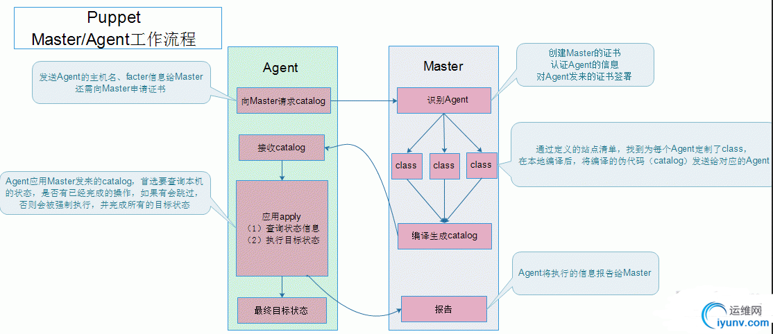

②Master/Agent的工作流程

2、配置Agent:
10
11
[iyunv@node2 ~]# puppet agent --server=node1 -v --no-daemonize --test --noop
Info: Creating a new SSL key for node2
Info: Caching certificate for ca
Info: csr_attributes file loading from /etc/puppet/csr_attributes.yaml
Info: Creating a new SSL certificate request for node2
Info: Certificate Request fingerprint (SHA256): 4B:92:71:6A:48:48:37:36:C1:12:84:63:C1:C1:57:40:7E:58:5C:29:ED:D9:57:F4:B0:79:8D:AE:25:C4:AF:E1
Info: Caching certificate for ca                    //等待ca颁发证书
Exiting; no certificate found and waitforcert is disabled
//在node1上显示如下的信息,说明已收到node2的证书申请
Notice: node2 has a waiting certificate request

[iyunv@node2 ~]# puppet agent --server=node1 -v --no-daemonize  //在agent上查看
Info: Caching certificate for node2
Info: Caching certificate_revocation_list for ca
Notice: Starting Puppet client version 3.6.2
Info: Retrieving pluginfacts
Info: Caching catalog for node2
Info: Applying configuration version '1448189086'
Info: Creating state file /var/lib/puppet/state/state.yaml
Notice: Finished catalog run in 0.02 seconds
