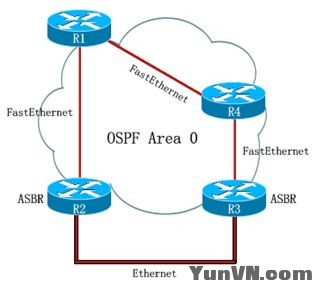

1.转发地址影响选路(1)
1.1实验拓扑
1.2实验需求
(1)按拓扑完成基本配置
(2)R2、R3上写一条相同的静态路由,ip route 10.10.10.0 255.255.255.0 31.31.23.100
(3)重分发静态路由进入OSPF进程,观察LSA Type 5以及R1的选路情况
(4)R2将与R3之间网络宣告进OSPF,R3不作改变,观察LSA Type 5以及R1的选路情况
1.3实验步骤
(1)静态路由
R2(config)#ip   route 10.10.10.0 255.255.255.0 31.31.23.100
R2(config)#router   ospf 1
R2(config-router)#redistribute   static subnets
R3做相同配置
R2#show ip ospf database external | include Forward
        Forward Address: 0.0.0.0
R2上Forward Address有两个输出,这是因为该网络中有两台ASBR携带外部路由,此时转发地址为0.0.0.0
(2)R1选路
R1#show ip ospf border-routers
OSPF   Process 1 internal Routing Table
Codes:   i - Intra-area route, I - Inter-area route
i   2.2.2.2 [1] via 31.31.12.2, FastEthernet0/0,   ASBR, Area 0, SPF 6
i   3.3.3.3 [2] via 31.31.14.4, FastEthernet1/0,   ASBR, Area 0, SPF 6
由于通告外部路由的是ASBR,且此时转发地址为0.0.0.0,外部路由类型为Type-2
由上输出可见,R1去往ASBR R2的开销更小
R1#show   ip route ospf
     10.0.0.0/24 is subnetted, 1 subnets
O   E2    10.10.10.0   [110/20] via 31.31.12.2, 00:03:29,   FastEthernet0/0
     31.0.0.0/24 is subnetted, 3 subnets
O       31.31.34.0 [110/2] via 31.31.14.4,   00:03:29, FastEthernet1/0
可见此时R1选择R2去往外部网络
(3)R2、R3直连网络参与R2 OSPF进程
R2(config-router)#network 31.31.23.2 0.0.0.0 a 0
            OSPF Router with ID (2.2.2.2)   (Process ID 1)
                Type-5 AS External Link   States
  LS age: 15
  Options: (No TOS-capability, DC)
  LS Type: AS External Link
  Link State ID: 10.10.10.0 (External Network   Number )
  Advertising Router:   2.2.2.2
  LS Seq Number: 80000002
  Checksum: 0xB50A
  Length: 36
  Network Mask: /24
        Metric Type: 2 (Larger than any link   state path)
        TOS: 0
        Metric: 20
        Forward   Address: 31.31.23.100
        External Route Tag: 0
  Routing Bit Set on this LSA
  LS age: 359
  Advertising Router: 3.3.3.3
  LS Seq Number: 80000001
  Checksum: 0x2452
  Length: 36
  Network Mask: /24
        TOS: 0
        Metric: 20
根据转发地址判定规则,此时由R2通告的路由,其转发地址为静态路由中的下一跳
(4)R1选路
i   2.2.2.2 [1] via 31.31.12.2, FastEthernet0/0,   ASBR, Area 0, SPF 7
i   3.3.3.3 [2] via 31.31.14.4, FastEthernet1/0,   ASBR, Area 0, SPF 7
此时去往ASBR的开销并没有发生变化
O   E2    10.10.10.0   [110/20] via 31.31.14.4, 00:04:47,   FastEthernet1/0
     31.0.0.0/24 is subnetted, 4 subnets
O       31.31.23.0 [110/11] via 31.31.12.2,   00:04:47, FastEthernet0/0
O       31.31.34.0 [110/2] via 31.31.14.4,   00:04:47, FastEthernet1/0
此时R1去往外部网络选择R4作为下一跳
1.4实验结论
当出现转发地址时,当前路由器将以去往转发地址的开销作为参考依据而不再是去往ASBR的开销

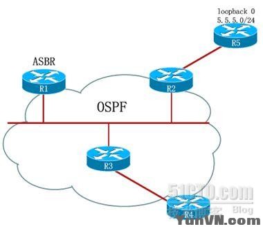

2.转发地址影响选路(2)
2.1实验拓扑
2.2实验需求
(1)按拓扑完成基本配置
(2)R2上写去往5.5.5.0的静态路由指向R5,R5上写缺省路由指向R2以保证连通性
(3)R1上写一条去往5.5.5.0的静态路由,只指定出口,重分发该路由进入OSPF进程,观察实验现象
(4)静态路由增加下一跳为R2,观察实验现象
(5)R4上写一条静态路由,ip   route 31.31.123.0 255.255.255.0 null 0,观察实验现象
2.3实验步骤
(1)完成需求(2)
R2(config)#ip   route 5.5.5.0 255.255.255.0 31.31.25.5
R5(config)#ip   route 0.0.0.0 0.0.0.0 31.31.25.2
(2)完成需求(3)
R1(config)#ip   route 5.5.5.0 255.255.255.0 f0/0
R1(config)#router   ospf 1
R1(config-router)#redistribute   static subnets
R1#show ip ospf database external | include Forward
R4#traceroute   5.5.5.5
Type   escape sequence to abort.
Tracing   the route to 5.5.5.5
  1 31.31.34.3 60 msec 32 msec 44 msec
  2 31.31.123.1   80 msec 60 msec 88 msec
  3 31.31.123.2   68 msec 68 msec 120 msec
  4 31.31.25.5 124 msec *  76 msec
此时数据包走了一条次优路径
R3#show ip route ospf
     5.0.0.0/24 is subnetted, 1 subnets
O   E2    5.5.5.0   [110/20] via 31.31.123.1, 00:01:53,   FastEthernet0/0
R3上目标网络下一跳为R1
(3)完成需求(4)
R1(config)#no   ip route 5.5.5.0 255.255.255.0
R1(config)#ip   route 5.5.5.0 255.255.255.0 31.31.123.
R1#show ip ospf database external | in Forward
        Forward   Address: 31.31.123.2
此时产生了转发地址
O   E2    5.5.5.0   [110/20] via 31.31.123.2, 00:00:57,   FastEthernet0/0
此时R3将转发地址作为下一跳
(4)完成需求(5)
R4(config)#ip route 31.31.123.0 255.255.255.0 null0
R4#show ip ospf database external | in Forward
R4#show   ip route static
     31.0.0.0/24 is subnetted, 2 subnets
S       31.31.123.0 is   directly connected, Null0
在R4上,此时转发地址不可达
R4#show ip route ospf
输出为空
            OSPF Router with ID (4.4.4.4)     (Process ID 1)
  LS age: 308
  Link State ID: 5.5.5.0 (External Network     Number )
  Advertising Router: 1.1.1.1
  Checksum: 0x428F
  Length: 36
  Network Mask: /24
        TOS: 0
        Metric: 20
R3#show ip ospf database external
            OSPF Router with ID (3.3.3.3)     (Process ID 1)
  LS age: 317
  Checksum: 0x428F
  Length: 36
  Network Mask: /24
        TOS: 0
        Metric: 20
此时R4上,该LSA失效,Routing Bit   Set on this LSA消息
2.4实验结论
(1)转发地址可以避免次优路径问题
(2)当转发地址在本地失效时,对应外部网络也将无效
