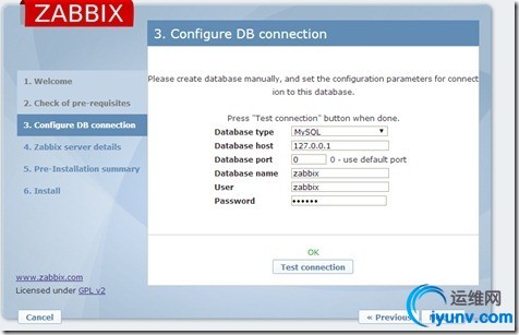

  5.3创建指定数据库和用户  mysql> create database zabbix character set utf8;
  Query OK, 1 row affected (0.06 sec)
  mysql>  grant all on zabbix.* to zabbix@localhost identified by 'redhat';
  Query OK, 0 rows affected (0.05 sec)

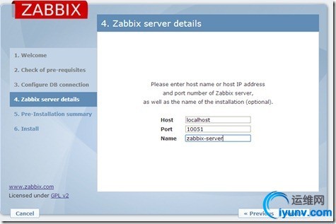

  6.7进入web界面配置  htttp://172.30.0.195:88

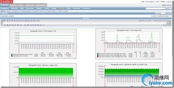

  7.2.6 检查agent是否成功(另需要在zabbix中查看host是否有一个Z绿色标志)  netstat -utlnp | grep zabbix
  /usr/local/zabbix/bin/zabbix_get  -s172.30.0.233 -p10050 -k"net.if.in[eth0]"
  /usr/local/zabbix/bin/zabbix_get  -s172.30.0.233 -p10050 -k"system.uptime"
