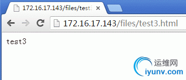

6、配置结束之后,重启服务器可以去测试反代效果如何?
查看反代日志
[iyunv@backproxy ~]# tail -2 /var/log/nginx/access.log
172.16.1.100 - - [04/Dec/2015:22:18:20 +0800] "GET /images/love.jpg HTTP/1.1" 304 0 "-" "Mozilla/5.0 (Windows NT 6.1; WOW64) AppleWebKit/537.36 (KHTML, like Gecko) Chrome/46.0.2490.86 Safari/537.36"
172.16.1.100 - - [04/Dec/2015:22:18:20 +0800] "GET /images/love.jpg HTTP/1.1" 200 190166 "-" "Mozilla/5.0 (Windows NT 6.1; WOW64) AppleWebKit/537.36 (KHTML, like Gecko) Chrome/46.0.2490.86 Safari/537.36"
7、接着尝试down机一台存储服务器测试效果如何
[iyunv@mogilefs2 ~]# service mogstored stop
Stop mogstored                                         [  OK  ]
对于前段访问后端存储服务器不会出现任何问题
