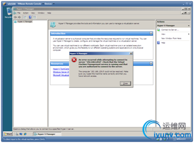

  Unfortunately, I received the following error when attempting to connect to my Hyper-V Server 2008.
  The problem occurs because Server 2008 and Hyper-V Server are in a workgroup and not a domain. The error I received contains “check that the virtual machine management service is running and that you are authorized to connect to the server.”
  After some “angry” Google-ing my best guess for a production deployment resolution is to follow the advice at http://blogs.technet.com/jhoward/archive/2008/03/28/part-1-hyper-v-remote-management-you-do-not-have-the-requested-permission-to-complete-this-task-contact-the-administrator-of-the-authorization-policy-for-the-computer-computername.aspx

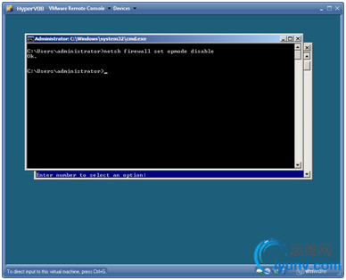

  Since I was tired of making configuration changes, in a lab setting, and lazy I just disabled the Hyper-V Server 2008 Firewall using a console command I found at http://www.realtime-windowsserver.com/tips_tricks/2007/08/server_2008_core_crib_sheet.htm.
  “Disable the firewall (at least until everything is working):
netsh firewall set opmode disable
  I also found some info about remotely managing a Windows 2008 Server Core firewall at http://www.petri.co.il/remotely-managing-windows-2008-server-core-firewall.htm.
  Finally I was able to connect with the Hyper-V Manager and build a VM.
