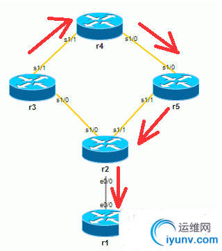

1、网络拓扑图
IOU设备接口连接说明:
r1 e0/0 r2 e0/0
r2 s1/0 r3 s1/0
r2 s1/1 r5 s1/1
r3 s1/1 r4 s1/1
r5 s1/0 r4 s1/0
1:0/0 2:0/0 rip
2:1/0 3:1/0 rip
2:1/1 5:1/1 rip
3:1/1 4:1/1 ospf
5:1/0 4:1/0 ospf

3、次优路径的控制
r3#sh ip route
Codes: L - local, C - connected, S -static, R - RIP, M - mobile, B - BGP
      D - EIGRP, EX - EIGRP external, O - OSPF, IA -OSPF inter area
      N1 - OSPF NSSA external type 1, N2 - OSPF NSSA external type 2
      E1 - OSPF external type 1, E2 - OSPF external type 2
      i - IS-IS, su - IS-IS summary, L1 - IS-IS level-1, L2 - IS-IS level-2
      ia - IS-IS inter area, * - candidate default, U - per-user static route
      o - ODR, P - periodic downloaded static route, + - replicated route
Gateway of last resort is not set
     1.0.0.0/32 is subnetted, 1 subnets
O E2    1.1.1.1 [110/20] via 192.168.34.4,00:11:48, Serial1/1
     3.0.0.0/32 is subnetted, 1 subnets
C       3.3.3.3 is directly connected,Loopback0
     4.0.0.0/32 is subnetted, 1 subnets
O       4.4.4.4 [110/65] via 192.168.34.4,00:11:56, Serial1/1
     5.0.0.0/32 is subnetted, 1 subnets
O       5.5.5.5 [110/129] via 192.168.34.4,00:11:56, Serial1/1
     11.0.0.0/32 is subnetted, 1 subnets
O E2    11.11.11.11 [110/20] via192.168.34.4, 00:11:48, Serial1/1
O E2 192.168.12.0/24 [110/20] via 192.168.34.4, 00:11:48, Serial1/1
     192.168.23.0/24 is variably subnetted, 2 subnets, 2 masks
C       192.168.23.0/24 is directly connected, Serial1/0
L       192.168.23.3/32 is directly connected, Serial1/0
O E2 192.168.25.0/24 [110/20] via 192.168.34.4, 00:11:57, Serial1/1
     192.168.34.0/24 is variably subnetted, 2 subnets, 2 masks
C       192.168.34.0/24 is directly connected, Serial1/1
L       192.168.34.3/32 is directly connected, Serial1/1
O    192.168.45.0/24 [110/128] via 192.168.34.4, 00:11:57, Serial1/1
r3#traceroute 11.11.11.11
Type escape sequence to abort.
Tracing the route to 11.11.11.11
  1192.168.34.4 8 msec 8 msec 12 msec
  2192.168.45.5 16 msec 20 msec 16 msec
  3192.168.25.2 20 msec 16 msec 16 msec
  4192.168.12.1 20 msec *  20 msec
产生了次优路径!
  1    192.168.34.4 8 msec 12 msec 8 msec
  2    192.168.45.5 16 msec 20 msec 16 msec
  3    192.168.25.2 20 msec 16 msec 16 msec
  4    192.168.23.3 28 msec 24 msec 28 msec
  5    192.168.34.4 28 msec 28 msec 24 msec
  6    192.168.45.5 36 msec 36 msec 32 msec
  7    192.168.25.2 36 msec 36 msec 36 msec
  8    192.168.23.3 44 msec 36 msec 48 msec
  9    192.168.34.4 40 msec 44 msec 40 msec
10    192.168.45.5 56 msec 52 msec 48 msec
11    192.168.25.2 52 msec 48 msec 56 msec
12    192.168.23.3 60 msec 56 msec 64 msec
13    192.168.34.4 56 msec 64 msec 60 msec
14    192.168.45.5 68 msec 72 msec 72 msec
15    192.168.25.2 72 msec 64 msec 72 msec
16    192.168.23.380 msec 76 msec 80 msec
17    192.168.34.4 76 msec 80 msec 80 msec
18    192.168.45.5 92 msec 84 msec 84 msec
19    192.168.25.2 92 msec 88 msec 84 msec
20    192.168.23.3 96 msec 100 msec 100 msec
21    192.168.34.4 92 msec 100 msec 100 msec
22    192.168.45.5 108 msec 108 msec 104 msec
23    192.168.25.2 108 msec 104 msec 104 msec
24    192.168.23.3 116 msec 112 msec 116 msec
25    192.168.34.4 108 msec 120 msec 112 msec
26    192.168.45.5 128 msec 120 msec 124 msec
27    192.168.25.2 124 msec 124 msec 124 msec
28    192.168.23.3 132 msec 124 msec 132 msec
29    192.168.34.4 132 msec 132 msec 136 msec
30    192.168.45.5 140 msec 140 msec 132 msec
产生环路!

去往11.11.11.11优先从r3走,故产生环路!

r3# traceroute 11.11.11.11
  1192.168.34.4 8 msec 12 msec 8 msec
  2 192.168.45.516 msec 20 msec 20 msec
  3192.168.25.2 16 msec 20 msec 16 msec
  4192.168.12.1 16 msec *  20 msec
产生次优路径!
