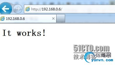

4、启动&测试
# /usr/local/apache/bin/apachectl start
如果成功,可以停止 Apache 服务器并继续安装 PHP:
/usr/local/apache2/bin/apachectl stop
OR
/usr/local/apache/bin/apachectl -k stop(推荐)

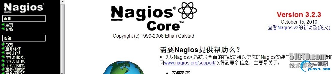

14、验证nagios页面
wKioL1OCrKyBTwULAAIgihKH0Ow281.jpg 15、错误提示

members                          nagiosadmin
7 检测配置是否正确
[Nagios~]# /usr/local/nagios/bin/nagios -v /usr/local/nagios/etc/nagios.cfg
