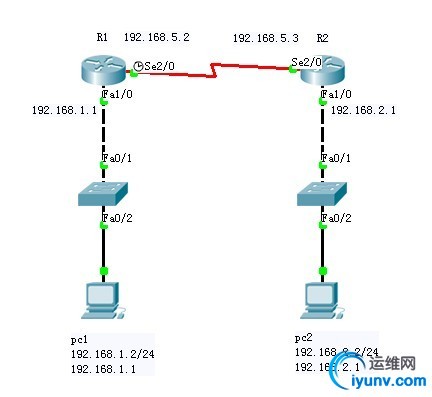

实验拓扑
1、在路由器R1、R2上配置接口的IP地址和R1串口上的时钟频率;
2、查看路由器生成的直连路由;
3、在路由器R1、R2上配置静态路由;
4、验证R1、R2上的静态路由配置;
5、将PC1、PC2主机默认网关分别设置为与路由器接口f1/0 IP地址;
6、PC1、PC2主机之间可以互相通信;
R1:

R2:

五、测试
Packet Tracer PC Command Line 1.0
PC>ipconfig
IP Address......................: 192.168.1.2
Subnet Mask.....................: 255.255.255.0
Default Gateway.................: 192.168.1.1
PC>ping 192.168.2.2
Pinging 192.168.2.2 with 32 bytes of data:
Request timed out.
Reply from 192.168.2.2: bytes=32 time=17ms TTL=126
Reply from 192.168.2.2: bytes=32 time=21ms TTL=126
Reply from 192.168.2.2: bytes=32 time=16ms TTL=126
Ping statistics for 192.168.2.2:
    Packets: Sent = 4, Received = 3, Lost = 1 (25% loss),
Approximate round trip times in milli-seconds:
    Minimum = 16ms, Maximum = 21ms, Average = 18ms
PC>
