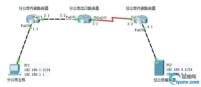

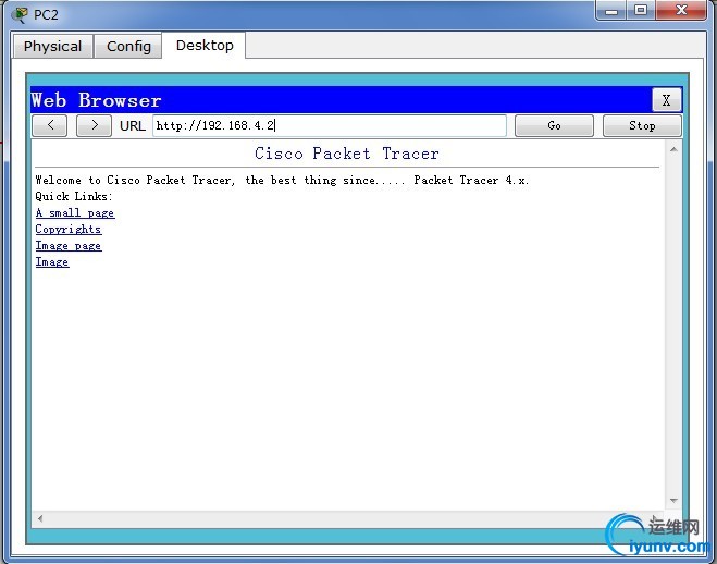

分公司和总公司分别属于不同的网段,部门之间用路由器进行信息传递,为了安全起见,分公司领导要求部门主机只能访问总公司服务器的WWW服务,不能对其使用ICMP服务。

1、分公司出口路由器与外部路由器之间通过V.35电缆串口连接,DCE端连接在R2上,配置其时钟频率64000;主机与路由器通过交叉线连接;
2、配置PC机、服务器及路由器接口IP地址;
3、在各路由器上配置静态路由协议,让PC间能互相ping通,因为只有在互通的前提下才能涉及到访问控制列表;
4、在R2上配置编号的IP扩展访问控制列表;
5、将扩展IP访问列表应用到接口上;
6、验证主机之间的互通性;

R2(config)#access-list 100 permit tcp host 192.168.1.2 host 192.168.4.2 eq www ?      //www服务
  dscp         Match packets with given dscp value
  established  established
  precedence   Match packets with given precedence value
  <cr>

R2(config-if)#ip access-group 100 ?
  in   inbound packets
  out  outbound packets
R2(config-if)#ip access-group 100 out ?
  <cr>
R2(config-if)#ip access-group 100 out                        //将控制列表应用于s2/0端口
R2(config-if)#
R2(config-if)#
R2(config-if)#end
R2#
%SYS-5-CONFIG_I: Configured from console by console
R2#show run
R2#show running-config
Building configuration...
Current configuration : 901 bytes
version 12.2
no service timestamps log datetime msec
no service timestamps debug datetime msec
no service password-encryption
hostname R2
interface FastEthernet0/0
ip address 192.168.2.2 255.255.255.0
duplex auto
speed auto
interface FastEthernet1/0
no ip address
duplex auto
speed auto
shutdown
interface Serial2/0
ip address 192.168.3.1 255.255.255.0
clock rate 64000
interface Serial3/0
no ip address
shutdown
interface FastEthernet4/0
no ip address
shutdown
interface FastEthernet5/0
no ip address
shutdown
ip classless
ip route 192.168.1.0 255.255.255.0 192.168.2.1
ip route 192.168.4.0 255.255.255.0 192.168.3.2
access-list 100 deny icmp host 192.168.1.2 host 192.168.4.2 echo
line con 0
line vty 0 4
login
end
R2#
R3:
Router>en
Router#conf t
Enter configuration commands, one per line.  End with CNTL/Z.
Router(config)#hostname R3
R3(config)#int fa0/0
R3(config-if)#ip add 192.168.4.1 255.255.255.0
R3(config-if)#no shut
%LINK-5-CHANGED: Interface FastEthernet0/0, changed state to up
%LINEPROTO-5-UPDOWN: Line protocol on Interface FastEthernet0/0, changed state to up
R3(config-if)#exit
R3(config)#int s2/0
R3(config-if)#ip add 192.168.3.2 255.255.255.0
%LINK-5-CHANGED: Interface Serial2/0, changed state to up
R3(config-if)#
R3(config-if)#
%LINEPROTO-5-UPDOWN: Line protocol on Interface Serial2/0, changed state to up
R3(config-if)#exit
R3(config)#ip route 0.0.0.0 0.0.0.0 192.168.3.1
R3(config)#end
R3#
R3#show ip route
Codes: C - connected, S - static, I - IGRP, R - RIP, M - mobile, B - BGP
       D - EIGRP, EX - EIGRP external, O - OSPF, IA - OSPF inter area
       N1 - OSPF NSSA external type 1, N2 - OSPF NSSA external type 2
       E1 - OSPF external type 1, E2 - OSPF external type 2, E - EGP
       i - IS-IS, L1 - IS-IS level-1, L2 - IS-IS level-2, ia - IS-IS inter area
       * - candidate default, U - per-user static route, o - ODR
       P - periodic downloaded static route
Gateway of last resort is 192.168.3.1 to network 0.0.0.0
C    192.168.3.0/24 is directly connected, Serial2/0
C    192.168.4.0/24 is directly connected, FastEthernet0/0
S*   0.0.0.0/0 [1/0] via 192.168.3.1
R3#
R3#
R3#show run
Current configuration : 667 bytes
version 12.2
hostname R3
ip address 192.168.4.1 255.255.255.0
duplex auto
speed auto
no ip address
duplex auto
speed auto
shutdown
interface Serial2/0
ip address 192.168.3.2 255.255.255.0
interface Serial3/0
no ip address
shutdown
no ip address
shutdown
no ip address
shutdown
ip classless
line con 0
line vty 0 4
login
end
R3#
PC1:
Packet Tracer PC Command Line 1.0
PC>ipconfig
IP Address......................: 192.168.1.2
Subnet Mask.....................: 255.255.255.0
Default Gateway.................: 192.168.1.1
PC>ping 192.168.4.2
Pinging 192.168.4.2 with 32 bytes of data:
Request timed out.
Request timed out.
Reply from 192.168.4.2: bytes=32 time=18ms TTL=125                 //ACL前
Reply from 192.168.4.2: bytes=32 time=12ms TTL=125
Ping statistics for 192.168.4.2:
    Packets: Sent = 4, Received = 2, Lost = 2 (50% loss),
Approximate round trip times in milli-seconds:
    Minimum = 12ms, Maximum = 18ms, Average = 15ms
PC>ping 192.168.4.2
Reply from 192.168.2.2: Destination host unreachable.              //ACL后
    Packets: Sent = 4, Received = 0, Lost = 4 (100% loss),
PC>
PC1-WEB测试:
ACL前后都可以访问web服务
