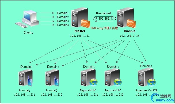

需求分析:
    现有4个域名通过HAProxy代理对外提供web服务,HAProxy是集群中的前端代理和负载调度器的角色,分别代理后端的多台Tomcat、Nginx+PHP、Apache服务器(Real Server),HAProxy同时搭建了两台,分别是Master和Backup,通过Keepalved实现双机热备,防止单点故障。HAProxy和Real Server的调度规则如下:
HAProxy --> Domain1 --> 192.168.1.10 --> 192.168.1.231/192.168.1.232(Nginx+PHP)
HAProxy --> Domain2 --> 192.168.1.10 --> 192.168.1.231:8080(Tomcat)
HAProxy --> Domain3 --> 192.168.1.10 --> 192.168.1.232:8080(Tomcat)
HAProxy --> Domain4 --> 192.168.1.10 --> 192.168.1.211:80(Apache)
实验拓扑:
环境介绍:(系统CentOS6.7)
Hostname
IPADDRRoleServer
master
192.168.1.33Director
haproxy-1.5.9 + keepalived
backup192.168.1.34Directorhaproxy-1.5.9 + keepalived
host1
192.168.1.231Real ServerTomcat Nginx PHP
host2192.168.1.232Real ServerTomcat Nginx PHP
host3192.168.1.211Real ServerApache MySQL
Web server:
Domain1: www.huangming.org
Domain2: web1.huangming.org
Domain3: web2.huangming.org
Domain4: www.localhost.com

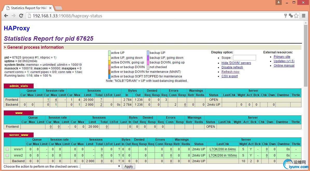

4、登陆HAProxy监测页面

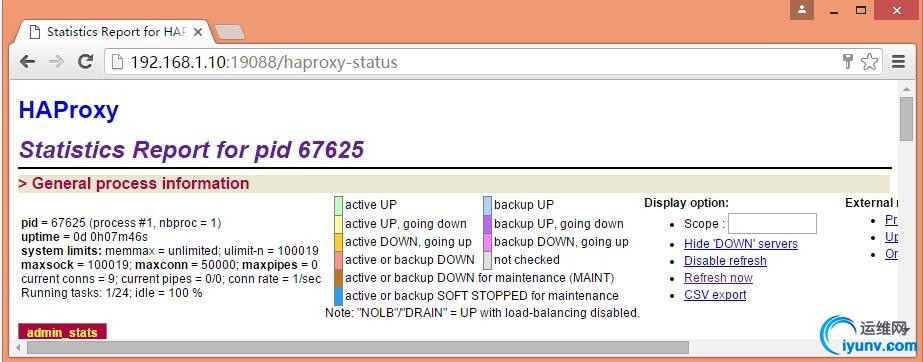

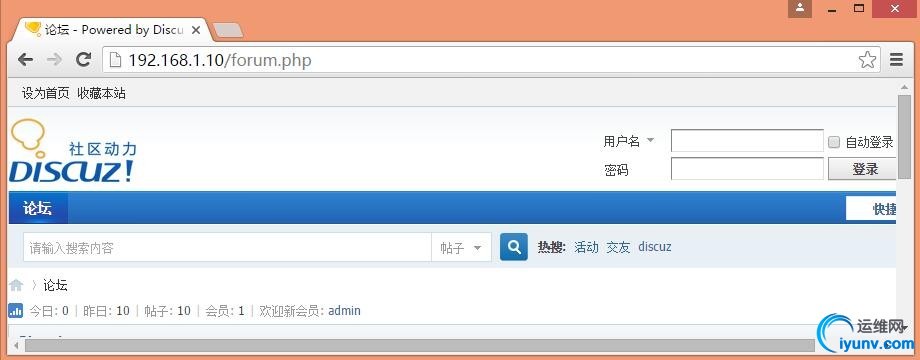

2、测试VIP是否正常提供服务
