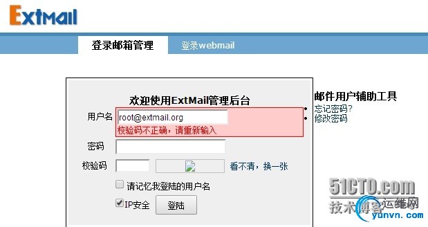

查看apache的错误日志报如下
[Mon Dec 16 16:58:58 2013] [error] [client 211.160.178.45] BEGIN failed--compilation aborted at /var/www/extsuite/extman/libs/Ext/GD.pm line 14., referer: http://1.1.1.1/extman/cgi/index. ... gin&error=vcode
[Mon Dec 16 16:58:58 2013] [error] [client 211.160.178.45] Compilation failed in require at /var/www/extsuite/extman/cgi/captcha.cgi line 22., referer: http://1.1.1.1/extman/cgi/index. ... gin&error=vcode
[Mon Dec 16 16:58:58 2013] [error] [client 211.160.178.45] BEGIN failed--compilation aborted at /var/www/extsuite/extman/cgi/captcha.cgi line 22., referer: http://1.1.1.1/extman/cgi/index. ... gin&error=vcode
[Mon Dec 16 16:58:58 2013] [error] [client 211.160.178.45] Premature end of script headers: captcha.cgi, referer: http://1.1.1.1/extman/cgi/index. ... gin&error=vcode
错误解决:
# yum install perl-GD
