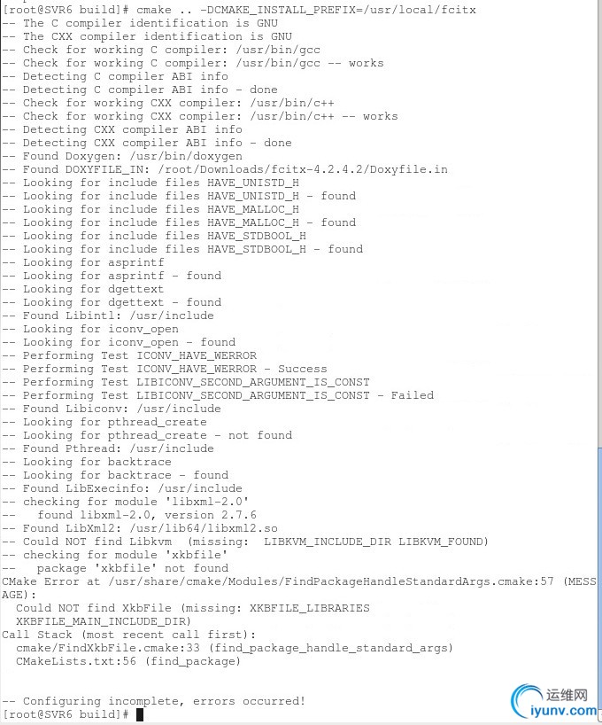

-- checking for module 'xkbfile'
--   package 'xkbfile' not found
CMake Error at /usr/share/cmake/Modules/FindPackageHandleStandardArgs.cmake:57 (MESSAGE):
  Could NOT find XkbFile (missing: XKBFILE_LIBRARIES
  XKBFILE_MAIN_INCLUDE_DIR)
Call Stack (most recent call first):
  cmake/FindXkbFile.cmake:33 (find_package_handle_standard_args)
  CMakeLists.txt:56 (find_package)
啊哦,出现了错误,查找下看看,原来提示说缺少package xkbfile,那就安装libxkbfile-devel
yum install libxkbfile-devel

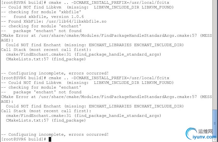

结果又出现了错误,错误原因:
  Could NOT find Enchant (missing: ENCHANT_LIBRARIES ENCHANT_INCLUDE_DIR)
  cmake/FindEnchant.cmake:31 (find_package_handle_standard_args)
  CMakeLists.txt:57 (find_package)
还是缺包,缺少package enchant,继续安装 enchant-devel

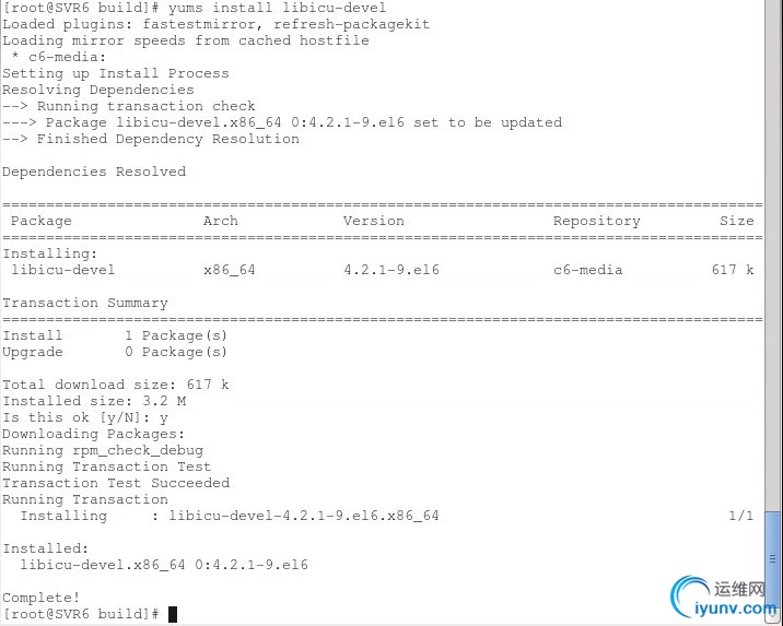

还是有错误,ICU,继续安装它们libicu-devel
这样就可以走完整个过程了:
结果如下:
接下来make,这个过程还挺快,有百分比显示,挺好,完毕后进行make install
