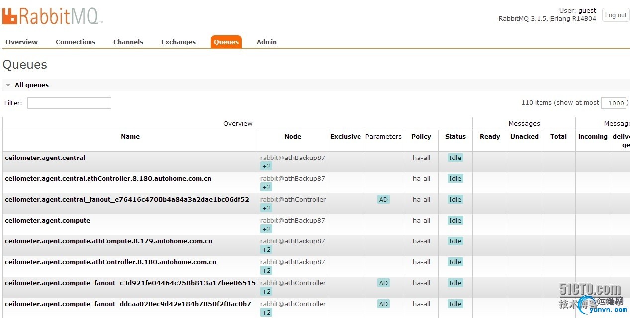

    4)    RabbitMQ镜像设置
           rabbitmqctl set_policy ha-all"^" '{"ha-mode":"all"}'
    3)    浏览RabbitMQ WEB 监控

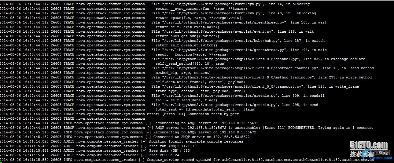

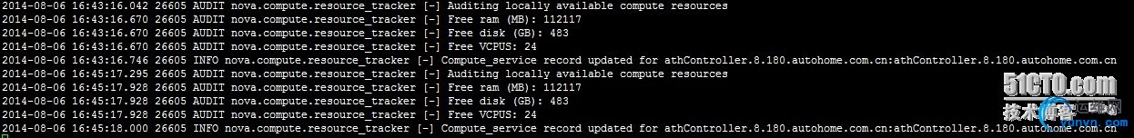

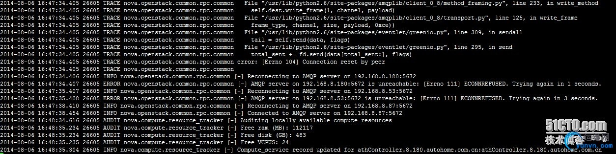

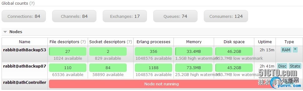

3.2 RabbitMQ HA 验证
2)stop RabbitMQ 集群
a)     [iyunv@athController nova]#/etc/init.d/rabbitmq-server stop
b)    Stopping rabbitmq-server:rabbitmq-server.
c)     [iyunv@athController nova]#
3)RabbitMQ 监控报警
4)Nova 错误日志
5)192.168.8.53:5672接管消息队列,已正常工作
   6)依次停止8.53:5672 消息服务,8.87:5672 正常接管

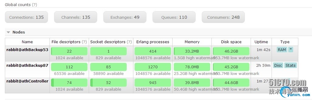

3.3 RabbitMQ 恢复
1)   主节点恢复启动MQ
[iyunv@athControllernova]# /etc/init.d/rabbitmq-server start
Startingrabbitmq-server: SUCCESS
rabbitmq-server.
2)   RabbitMQ 监控显示
