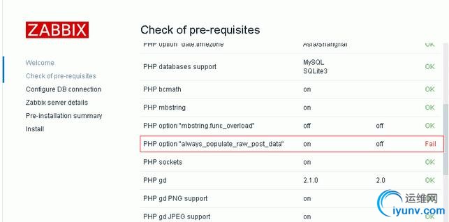

十二在浏览器里面安装http://ip/zabbix/setup.php我只把报错的地方贴了出来。
第二步报错:
解决办法
vim /目录/zabbix/include/classes/setup/CFrontendSetup.php,找到下面代码、关于always-populate-raw-post-data;
添加 $current =-1;
如下所示:
10
11
public functioncheckPhpAlwaysPopulateRawPostData() {
                $current =ini_get(‘always_populate_raw_post_data‘);
                $current = -1;
                return array(
                        ‘name‘ => _(‘PHPalways_populate_raw_post_data‘),
                        ‘current‘ =>($current != -1) ? _(‘on‘) : _(‘off‘),
                        ‘required‘ =>_(‘off‘),
                       ‘result‘ =>($current != -1) ? self::CHECK_FATAL : self::CHECK_OK,
                        ‘error‘ => _(‘PHPalways_populate_raw_post_data must be set to -1.‘)
然后  再回到页面刷新,正常:
