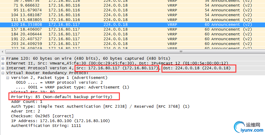

同时在主节点上面抓包,我们来简单分析下这个包
[iyunv@centos01 keepalived]# tcpdump -i eth0 -n -vvv -s0 -w httpd.cap
源IP对应的是主节点的IP地址 172.16.80.116,而目的地址是组播 224.0.0.18,当我们把主节点上面httpd服务停止时,可以看到 主节点上面优先级立刻变成0,也看到这里是明文传输的,密码 1111,接下来我们看下一个包
我们可以看到这个包源IP地址变成了备用节点的IP地址 172.16.80.117,而目标地址依然是224.0.0.18
从优先级85 我们也可知道这是备用节点设置的优先级

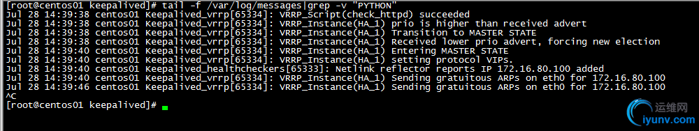

在主用节点上面启动httpd,观察日志
主节点上面
[iyunv@centos01 keepalived]# tail -f /var/log/messages|grep -v "PYTHON"
Jul 28 14:39:38 centos01 Keepalived_vrrp[65334]: VRRP_Script(check_httpd) succeeded
Jul 28 14:39:38 centos01 Keepalived_vrrp[65334]: VRRP_Instance(HA_1) prio is higher than received advert
Jul 28 14:39:38 centos01 Keepalived_vrrp[65334]: VRRP_Instance(HA_1) Transition to MASTER STATE
Jul 28 14:39:38 centos01 Keepalived_vrrp[65334]: VRRP_Instance(HA_1) Received lower prio advert, forcing new election
Jul 28 14:39:40 centos01 Keepalived_vrrp[65334]: VRRP_Instance(HA_1) Entering MASTER STATE
Jul 28 14:39:40 centos01 Keepalived_vrrp[65334]: VRRP_Instance(HA_1) setting protocol VIPs.
Jul 28 14:39:40 centos01 Keepalived_healthcheckers[65333]: Netlink reflector reports IP 172.16.80.100 added
Jul 28 14:39:40 centos01 Keepalived_vrrp[65334]: VRRP_Instance(HA_1) Sending gratuitous ARPs on eth0 for 172.16.80.100
Jul 28 14:39:46 centos01 Keepalived_vrrp[65334]: VRRP_Instance(HA_1) Sending gratuitous ARPs on eth0 for 172.16.80.100
可以看到vip地址再次漂移回主节点上面

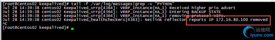

备用节点log
[iyunv@centos02 keepalived]# tail -f /var/log/messages|grep -v "PYTHON"
Jul 28 14:39:38 centos02 Keepalived_vrrp[4364]: VRRP_Instance(HA_1) Received higher prio advert
Jul 28 14:39:38 centos02 Keepalived_vrrp[4364]: VRRP_Instance(HA_1) Entering BACKUP STATE
Jul 28 14:39:38 centos02 Keepalived_vrrp[4364]: VRRP_Instance(HA_1) removing protocol VIPs.
Jul 28 14:39:38 centos02 Keepalived_healthcheckers[4363]: Netlink reflector reports IP 172.16.80.100 removed
可以看到备用节点上面vip地址被移除了

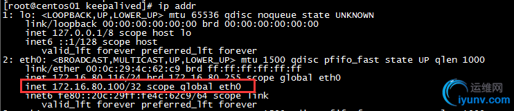

再来看看实际的vip地址情况
主用节点
备用节点
