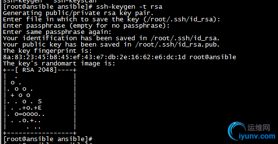

1、建立免秘钥登陆
[iyunv@ansible ansible]# ssh-keygen -t rsa  一路回车即可
[iyunv@ansible ansible]# ssh-copy-id -i /root/.ssh/id_rsa.pub 172.16.80.117
[iyunv@ansible ansible]# ssh-copy-id -i /root/.ssh/id_rsa.pub 172.16.80.118

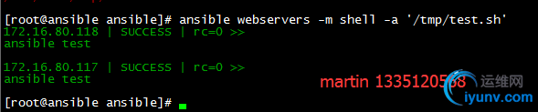

4.2 shell模块(需要执行客户机上的脚本可以用该模块,脚本在被控端)
[iyunv@ansible ansible]# ansible webservers -m shell -a '/tmp/test.sh'
说明:webservers是主机组的名称,-m  后面接的是模块名称,-a后是模块的参数

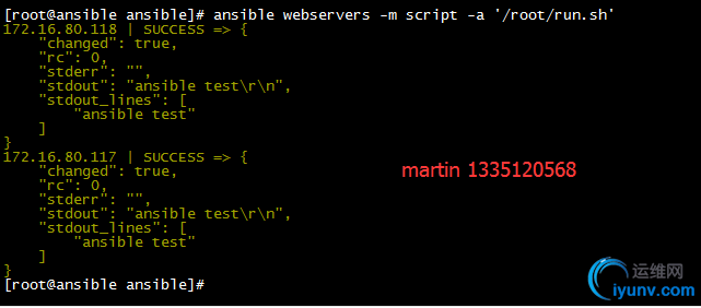

4.3script模块 (脚本在主控端)
[iyunv@ansible ansible]# ansible webservers -m script -a '/root/run.sh'

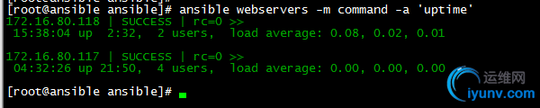

4.4 command模块
[iyunv@ansible ansible]# ansible webservers -m command -a 'uptime'

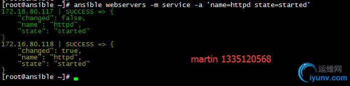

4.6 service模块
[iyunv@ansible ~]# ansible webservers -m service -a 'name=httpd state=started'
对服务的操作有 started  stopped restarted reloaded四个参数

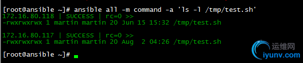

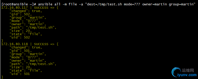

4.9 file模块
[iyunv@ansible ~]# ansible all -m file -a "dest=/tmp/test.sh mode=777 owner=martin group=martin"
