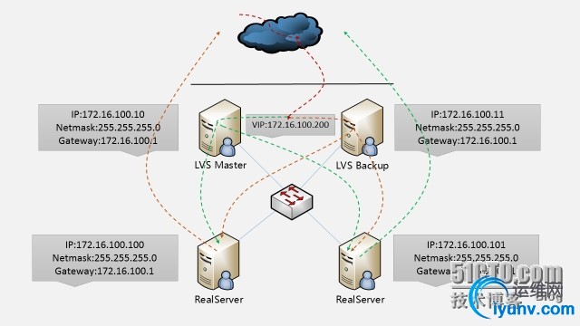

实验信息和拓扑:
备注:Centos 6.5 selinux –disabled iptables off
ServerNameIpaddress information
LVSMaster172.16.100.10/24
LVSBackup172.16.100.11/24
VIP172.16100.200/24
RealServer1172.16.100.100/24
RealServer2172.16.100.101/24
